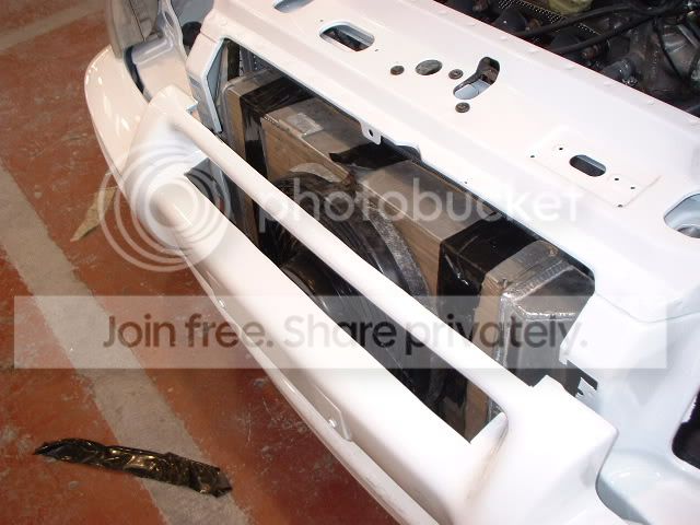

cooling side must be easy on them i have the first type much bigger and have had no probs fit to 10" fan on the rad then fit cooler job done just to be sure with the bonnet thing i moved the rad back just a tad i.e more up right, bottom in, you need a shorter belt for the alternator (spelling)

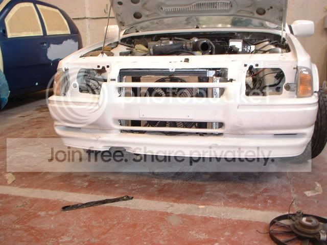

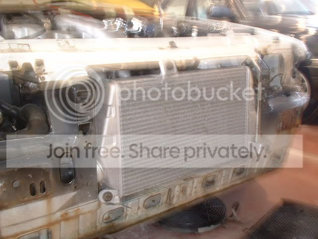

Maytee i should be quite easy to fit em to your car... here is one we fitted last week
