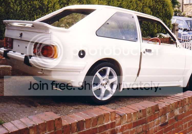

Old Nov 27, 2003 | 07:31 PM

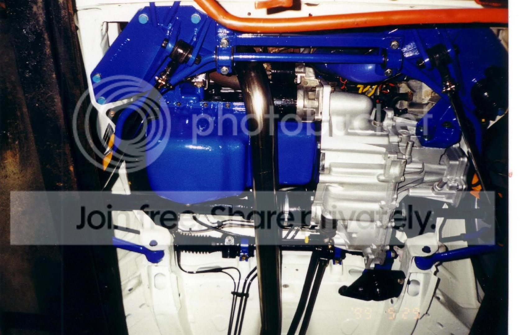

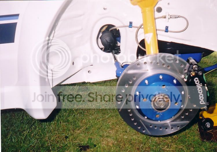

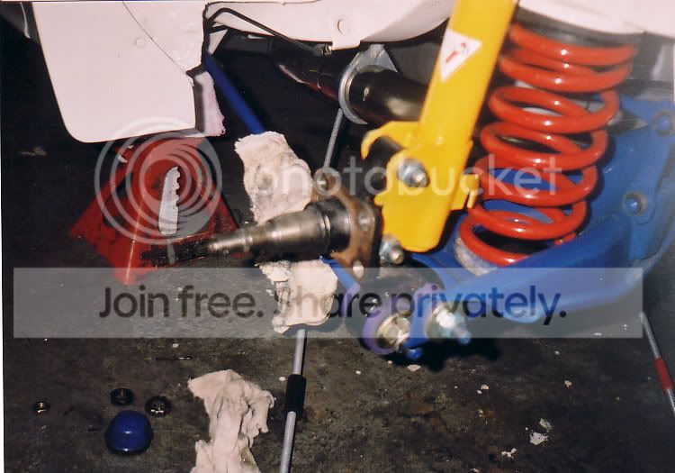

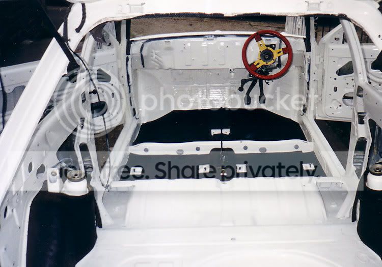

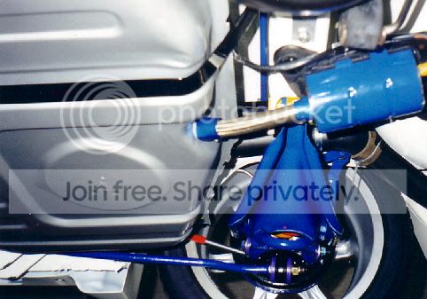

dan m8 rs gus has uploaded these pics of my old s1 some are not too good because i'm no david bailey. Th pics are of various stages through out the 3 years there was some of the rear discs and the brakes are 115mm on the front there was a feature in rally news in 2000 march april .............................this car was driven to all shows and never trailerd i wish you all the best with your s1 keep us posted ....craig....

Wicked pics mate, what power was it running when you finished it?
The whole car looks absoluetly stunning, no wonder you won so much with it mate!
What other parts were rusted when you got hold of it, I think the seals need doing on my MK3 (as they do on most escorts! ) and there are some seems around the engine bay that have gone too!
Had your Rear Chassis rails rusted like mine too, as im having trouble getting hold of some as you can tell, the nearest place to me that sells them is Abacus Parts in Bournemouth who have quoted £141 inc VAT, but Hadrian Panels say I can get the part from Abacus at £46.00 inc VAT!!

dan m8 it was just over 200 bhp it had a stg 3 hybrid on it head was ported it was chipped scorpion exhaust k&n plus other bits and bobs.If youlook in the trim shot you can just make out the bias valve i put in to sort out the rear discs, the hoses was goodridge from master cylinder to calipers all with stainless aeroquip ends.The rear chasis rails had started to blister so i chopped out all the rust until it was all good metal and welded in flush the same thickness of metal. I took all the floor to the bear metal on the under side once i had welded it up then i etch primed it up and carried on until finish... the car had every new piece i could get from ford but i had to improvise on a few nuts bolts washers anything cheers for the compliments i hope yours ends up how you want it.......cheers craig...
