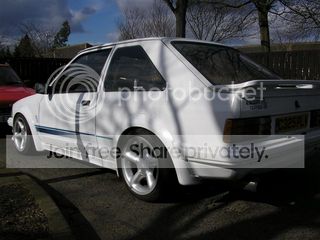

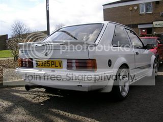

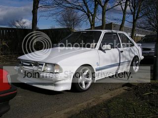

https://passionford.com/forum/viewto...asc&highlight=
Originally Posted by tonyturbo
215/40x16 tyres. front lips removed completely. arches trimmed to suit. you also have to trim the front spoiler just in front of the wheel or it will catch on full lock. on rears both skins on lip seperated and inner lip completly removed outer lip cut into 25mm sections and folded up tight against inner arch and seam welded. bodykit arch trimmed to suit. lowered 60mm on koni's didnt rub on full lock and didnt rub with fat coonts in back. wouldnt consider any other wheel for a s1 since i done that. i took a gamble and its paid off. i was the first person to put these rims onto a s1, way back in april 2001
