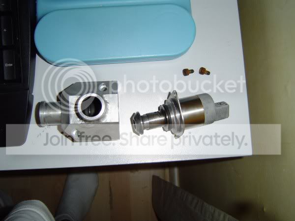

what air device are you using to by pass air simon?
great news that you got it going

heres the als valve block i made for my car
but i fooked the diode in there when fucking about one day
will do another one soon
