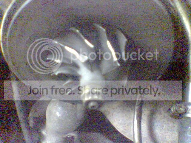

just bought a turbocahrger for the cossie, unsure if its a T34 or not, was sold as a T34, but on investigation now i'm home, appears to be a T3 not that i'm moaning - its in better condition than mine
it has the following number on the garret manufacturer plate for the model - TB03B4 or it could be TB0384 - can't quite make out the 2nd to last letter/didgit.
has a .48 exhaust housing, .42 compressor, with what looks like a 55 trim comp wheel, unusre of that tho.
can anyone shed any light onto it?

take a pic will confirm what it is

sounds like a 2wd t3...........does it have the alloy holder sticking out the side for the escos actuator????????

comp
exhaust
dataplate
its come off a 4x4 cossie eitherway and has a -31 actuator on it

It's just a standard 4x4 turbo (which is slightly better than a standard 2wd T3 anyway ).
Is no way a T34 though .

t3 from a 4x4 does your standard hose from the air filter fit if so it aint a t34

yep defo a t3

465189- which is on the tag is the garrett id = 4x4 std cos (60 trim)

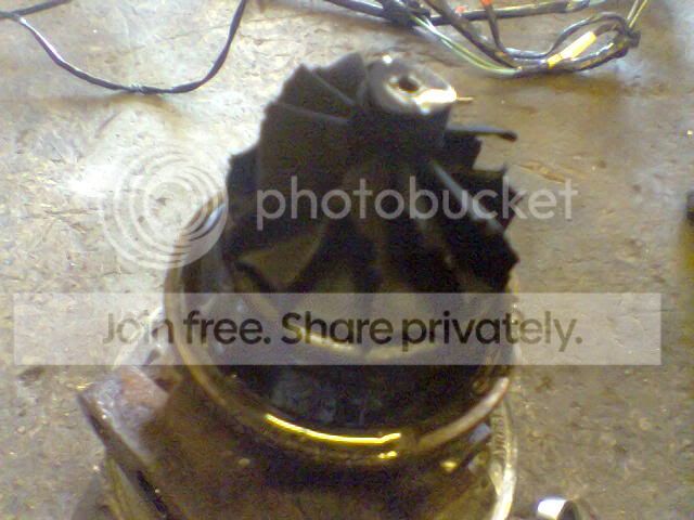

It is a better turbo on paper but in the real world of cosworths it's not ,it mashes itelf .
Sure plenty of people on here have had them loose the exhaust wheel.
bit like this one i did earlier
