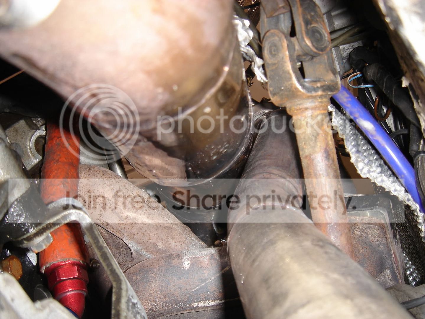

Don't forget if you have an external wastegate you are gonna have to shut the fooker up if you wanna do trackdays!
Old Apr 14, 2005 | 07:54 AM
Old Apr 14, 2005 | 08:40 AM
Rick's Avatar
Rick
Posts: 15,885
Likes: 17
From: Stockport, Cheshire
fcuk me, thats tight!

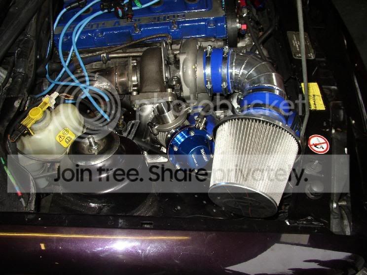

My old set-up GT35 & Turbosmart.
New GT40 arrived today & new manifold is due tomorrow. So soon be going again.
