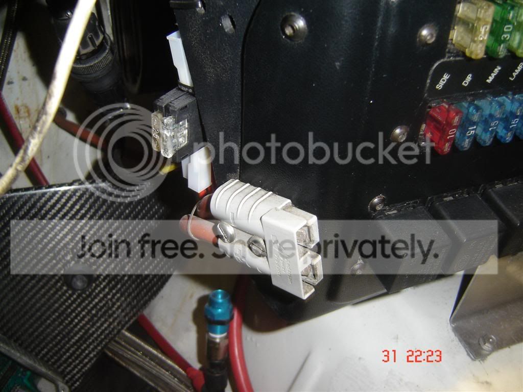

the other end to plug into this??? as i need it to jump start the car if i get a flat battery SORTED this part

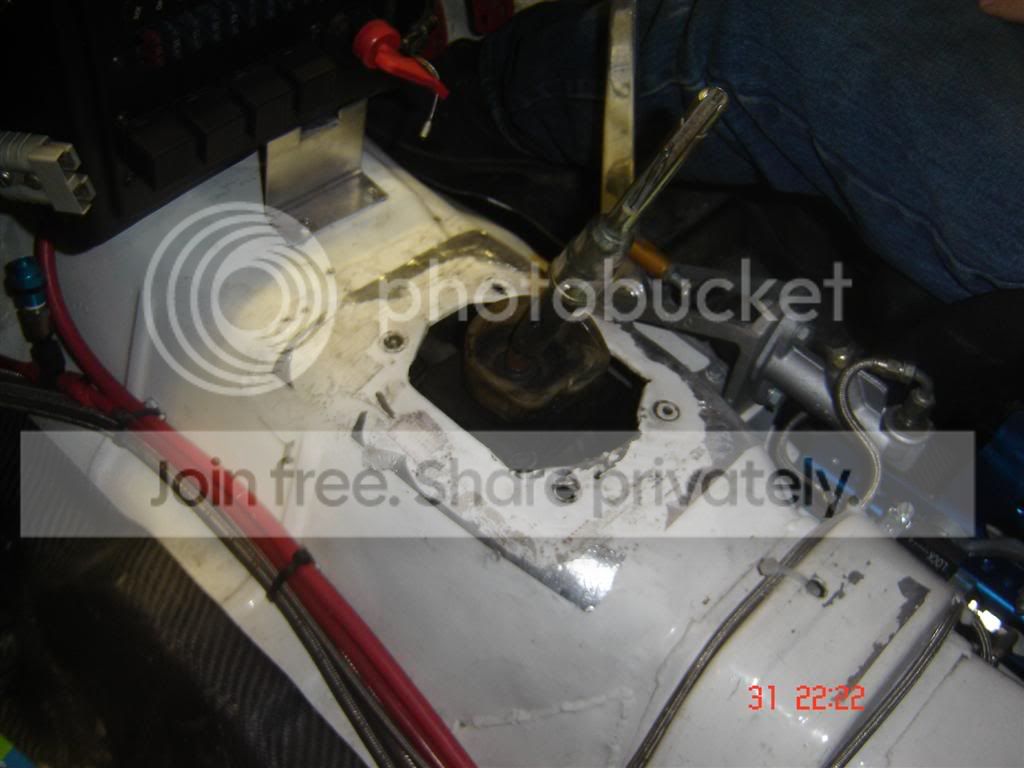

not sure whats missing here to make it look pretty

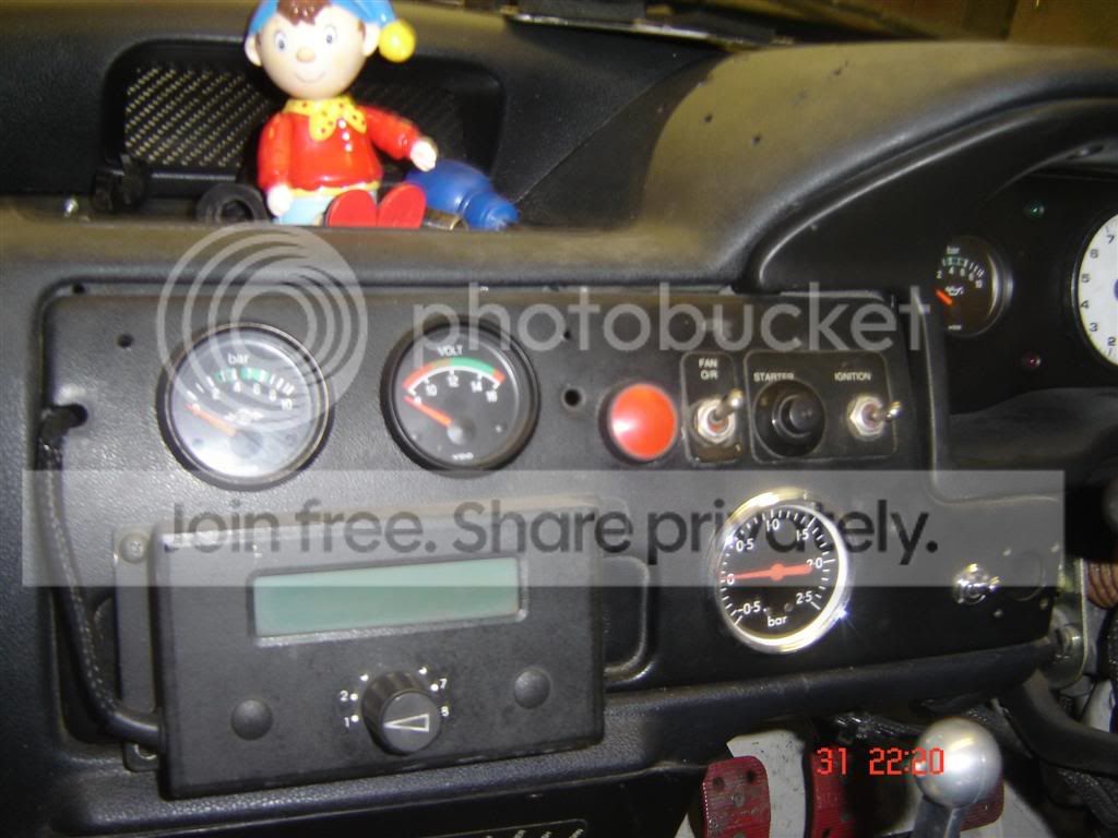

and i'd like the panel that all the gauges and switch are in blank so i can re design it

I think some nice carbon for the gauge panel and the gearlever surround would do the job.

carbon tunnel mmmmm good thinking

the plug you want you can get from vehicle wiring products on
: 0115 9305454.
175 amp connector, Includes two terminals which accept cables up to 40mm2
Red Ref: PP175R.....Ł9.66 ea
Grey Ref: PP175S.....Ł9.66 ea
Terminals for 35mm2 cables. Ref: 180536 ...Ł3.46 pair
Handle for PP175, Includes screws & nuts for mounting to connector.
Ref: PPH1. Ł7.79 ea
hope this helps these are the exact part numbers you need

beat me to it, but www.vehiclewiringproducts.co.uk do the connector.

For the gearbox cover, a lot of people make their own one up to cover the hole that's left, like on mine:
It's connected by two sliding c-clips to studs, and has a gaiter riveted in place, to try and keep the water out.

rich toy got a closer??? pic???
i've just emailed some for a price a dcarbon firbre tunnel, but i'm thinking that might be a bit steap...

As for the centre dash panel, I think Martin Hadland may be able to get you a blank Carbon one - not sure though..........

SPIKEY what you need is what you call an anderson lead plug,i have them at work,leave it with me
cheeRS stu

i need another of whats in that pic and 2 more of the other end so i can plug either video camera in or a battery pack

Spiky for the centre bit around the gearstick, just get any old ford Sierra from a breakers and just use the plastic surround, foam sealant and small rubber gaitor. Thats what I did and I think it looks fine mate.
Will take a piccy later for you mate

as it just looks a bit shitty as it is at the mo

love the DASHBOARD NODDY!!

it really is
and WILL be glued to dash soon

hi dude, with regards to that connector i needed
which one do i need, so i can order some
here is a link with them on, but unsure as to which i need.
http://www.vehicle-wiring-products.c.../battisol.html

SPIKEY totaly forgot,have plug in garage for you,just pm me your adress and send a few bear tokens in the post and all will be ok,might even be 2 plugs by tonight
cheeRS stu
