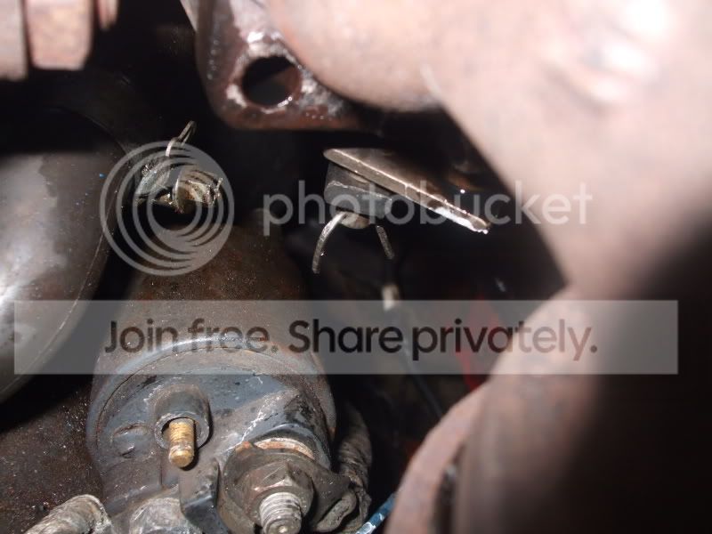

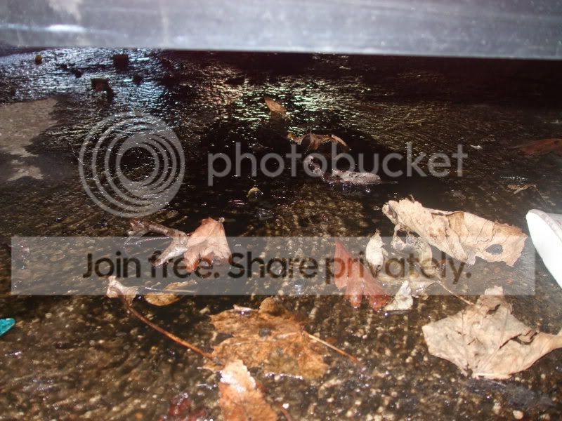

Just done my comp test and it shows nearly 10 bar, all 4 exactly the same. I have just noticed a nice big pool of oil under the car and it looks like its coming out of the bottom of the turbo I think there's a bolt missing and it's coming out of there, I'll go take a couple of pics tell me what you think.

If they are standard pistons then 10 Bar is really low mate!!
If you have a puddle of oil on the floor i bet it's coming form the oil return pipe from the turbo to the sump, it will be split! Runs onto the exhaust and looks like you are smoking from behind as your going along!! It's just above the starter motor mate.

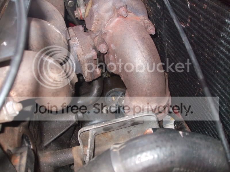

This bolt is missing under the turbo and has oil on it
All this oil has just come out from somewhere as it wasn't there 10 mins ago!

Check the oil return pipe you can see in the photo (sometimes splits where the jubilee clip is overtightend), because i'm not sure if oil passes through that part of the turbine housing where the bolt is missing.

10 bar is not low at all! It's perfect, especially as they are all equal. Your rear turbo seal has gone, nothing wrong with the engine.
