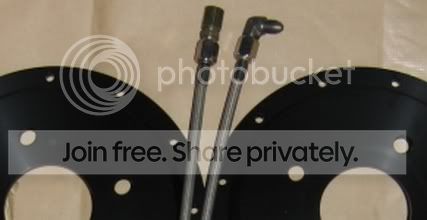

The little fitting we use is screwed into a line here
