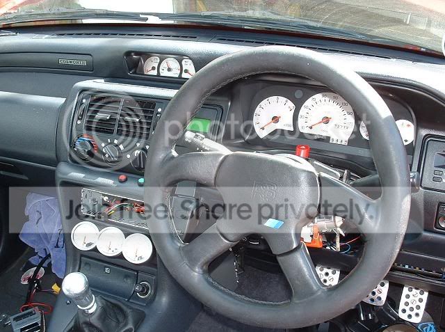

I have recently got hold of one of the 4 spoke steering wheels(later version with the 3 stripes).
Anyhow it came with a boss for a large turbo escort when i went to fit it to my small turbo escort(airbag model) it doesn't fit. ( i thought the column's were the same).
just wondering if any one has fitted one to their escort .
Any help greatly appreciated.
Regards Steve

youll need a special boss for your escort as its an airbag model

no chance from ford mate,try demon tweeks or similar,you might need an adaptor as well to suit your new wheel

yes i have one
complete pain in the arse as there is NO boss that fits!
i bought a momo Mk 5 boss and drilled and tapped it to accept the wheel
took AGES but is a proper job
PS, nice wheel isnt it!

yeah thats the one, think i'll be buying a momo steering wheel boss then.

Well, managed to get it to fit with just a slight bit of modifying. Managed to use the ford boss that came with it. Just need to take the clocks out and remove the airbag light. Steve

i fitted momo swheel 2 my airbag model escos .take wheel of and all stalks then ignition barrel at the end of steering column is an alloy over the shaft inside the alloy barrel is a white nylon washer tap the end of the alloy barrel 2 lossen it remove washer barrel will follow replace with barrel from non air bag model or mk 5 u also need shrouds from mk 5 as airbag ones r 2 big its so easy can talk u through it

Cheers Arty i have managed to get mine on thanks. Only needed to massage a small bit of metal. Your car looked good as usual on Sunday.

Not really as i had a hub that eventually fitted on the column
,but it may be easier if you have an early cossy as there no airbag to remove. To be honest if you can get a hub to fit on your column then its only a case of drilling and tapping to suit the wheel.

I know sparco used to list a boss for an early escort cossy. If you have an airbag model i couldn't find anyone who listed a boss for it.

Cheers paul the picture is from Daveescos cossy, however the wheel is the same.
