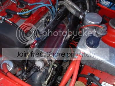

Here's the one we made for my car:
One we did for Doug Stirling's 568 bhp Escort:
One we did for Jtechsaff:
One we did for B9KOS
Si
