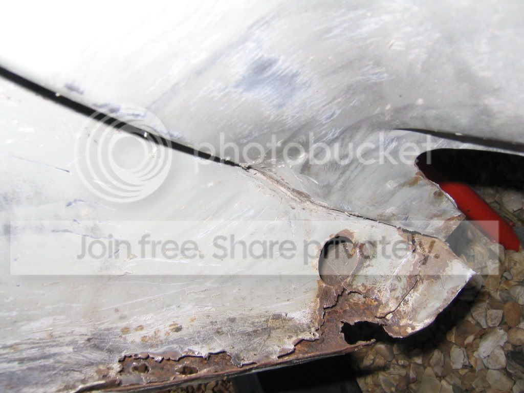

The worst bit of rust on the car wich im gonna weld up sometime this month. Never done welding before so will be a bit of a learning curve.

If there's just that little bit of welding to be done I'd pay a professional to do it right first time rather than messing with buying/hiring equiptment and then teaching yourself how to weld.
The handbrake cable in the picture is for a drum braked model. You need one for a 91-95 2.0 16v 150PS Escort (Non Cosworth). This has a half moon shaped bracket at the lever end and rectangular slots at the disc end.
