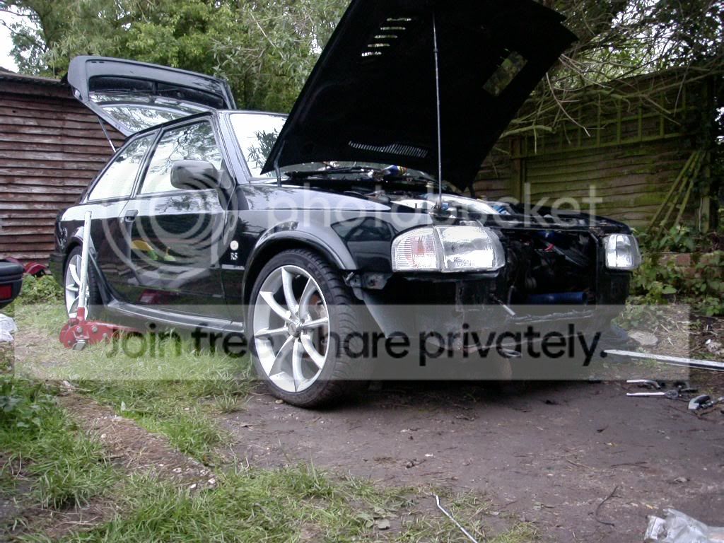

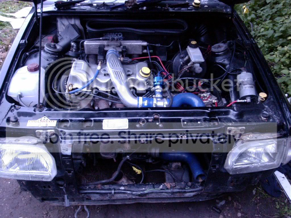

bought with the head off it and lookin in a sorry state i dragged it home in exchange for a reasonable sum of beans
i was going to just bung it back together but the tensioner bolt was sheared to with the big end out i dropped in a zvh i'd built for my estate
using the original head with its perf cam and larger ports
and a nice t3 i had for a while
she looked like this
all complete and back together the water pump leaked so thats been renewed today
now the camseal leaks so jot a job for tomorrow, also the alt lamp is on but its charging so fit a new alt too, some shady sod has attatched the abs lamp to the hand brake 1 too but i dont think my mot man will wear that
had a bit of welding done to the rear chassis and floor to sills shes now nearly there to getting a mot
