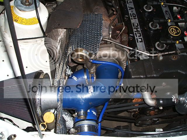

My home made heat sheild/air box
Old Feb 23, 2006 | 04:31 PM
rapidcossie's Avatar
rapidcossie
Posts: 14,907
From: scotland
Default My home made heat sheild/air box
what do you all think?
look too "homemade"?

sorry to say that looks cats bottom i take it you got idea from mad rod ?

Does look a bit of a blue peter attempt tbh
But if it does the job then

if it does the job then its all good
whats it made out of ?

that is the double of rod's! you should make them and sell them euan! top piece of kit!

nice tight fit round the turbo hose too

No Sorry mate that looks cack, I made one for the sapph once out of stainless
steel looked ok ish..
Did you nick that from NASA ..lol.......

Dont look to bad, its not as if you drive round with you bonnet open!

you get that stuff in sheets from demon tweeks.
is proper heat sheild for exhaust etc so will do the trick.
ok for my first attempt i thought.
wil make it again out of a more rigid material using that as a template...
thats just the angle...
its not really that big a gap...
is hard to cut and razor sharp, so thought was ok for first attempt

Sorry but as Dave would say it looks Pony
But at least it didn,t cost much and take you all day to do.

think ill defo just leave it on the car as no one seems to like it

i think you could improve it considerly just needs a bit more thought have another try it could be an evolution of the first

he dead right tho, if it works, who gives a fuck what it looks like.
rather have that and some genuine performance than some flashy looking engine and nothing to show for it barring lots of talk.
then again i cant see them heatshields doing much

Same stuff and it does work

yours does look a bit neater but thats about all. some people spend all this money on their cars then cut corners

function over form
it's like the famous broom handle mod for the removing the dump valve - don't look great, but it's cheap and it works. leaves more money for the important things like petrol, tyres, brakes etc

Euan, that looks PONY mate
not to mention dangerous.. how sharp are those edges!

rapidcossie You've got the right idea The material used is superb.
As you may know that material is available in three types:
Single sided
Double sided
Double sided with a ceramic layer sandwiched within = (f**king expensive!).
I was sent some post card sized samples by the manufacturer - one of each type.
Not a scientific test by any means - but a real eye opener:
Got a slice of frozen bread and put in on the grill (gas grill on maximum heat), timed how long it took to go brown (the usual brown colour for toast)........it took 46 seconds.
Then did the same test (again used a slice of frozen bread) with the single sided material directly on top of the frozen slice of bread:
It took 5 minutes to go brown......
And again with the double sided material: 8 minutes to go brown.
Then the ceramic stuff: The bread would NOT go brown in fact is stayed frozen for about 1 minute - I gave up after 12 mins........carefully lifted off the material (use tongs), the bread was still white, and was only slightly warm to the touch!

Measure ambient temps outside the car and measure the temp in the air filter. If it works I personally dont care what it looks like.
" looks " and function usually cost too much. So it depends on your budget.
I like Dougs test, thats the sorta test I would have done
back in the day I had a problem with my starter getting killed by my exhaust. We got hold of a pipe wrap that is used when welding. It was about 1 inch thick and SERIOUS stuff. You could put the wrap on your hand and put a piece of glowing red hot metal on your hand and have no idea.
Overkill but it worked

what about something along these lines:
Old Feb 24, 2006 | 06:27 PM
rapidcossie
Posts: 14,907
From: scotland
yeah holty that look good but costs 300 quid...
mine cost 20

you get it from demon tweeks
check it out under the heat management section

You could prob get a company to make up the box section fairly easily to work with your air filter
