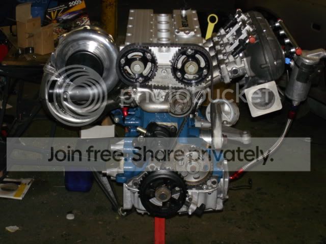

not sure if you will see it clearly but this engine has an EECIV pulley fitted with the aircon pulley removed

Big thanks to all.
Excellent pic Martin
