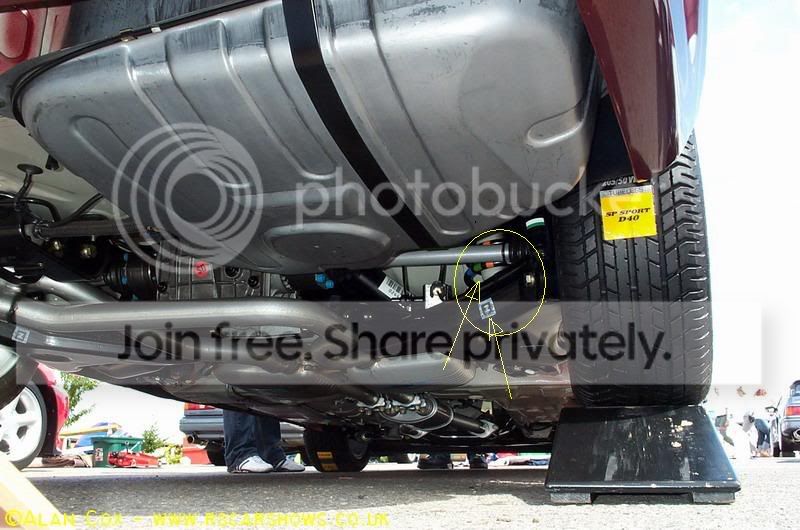

Oh and does anyone know what all the yellow marks are on mine. They were already on there when I got the car. Are they some sort of factory markings or something?
They could be colour swatches from the factory, if you look at some of the top standard class concours cars you'll see they've all got coloured marks/stamps on certain parts.
like in this pic
Old Aug 23, 2006 | 12:22 AM
ram's Avatar
ram
Has a large member
Posts: 4,186
From: oxFORDshire
yeh factories and garages use the yellow paint marks to show that that nut/bolt is tight and has been checked.
