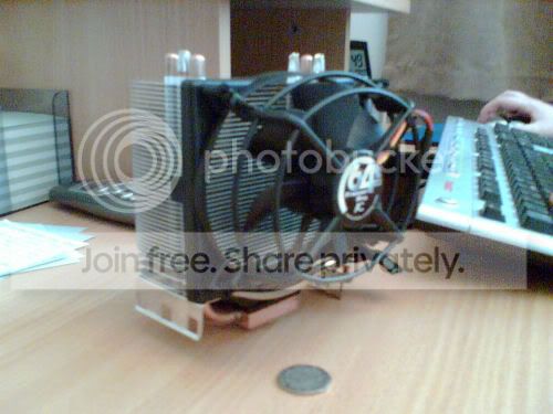

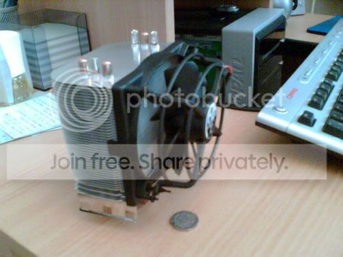

I had the same problem running my Nvidia 7800GTX, freezing then randomly reboots
I bought a 500w PSU and it still did it, then i bought a better 550w PSU for Ł65 and it still does it, i then proceeded to do more tests on the PC to find my 2x RAM sticks were running different speeds and clashing, so bought 2x 1GB matched Corsair platinum sticks (Ł150) and it still does it
I have since tonight bought extra cooling for the CPU and GFX card, bought a big mofo arctic cooler and an exhaust fan, upto ive had no crashes but we will see!
Old May 24, 2006 | 08:26 PM
Zetec Andy's Avatar
Zetec Andy
Posts: 13,421
From: Speed bump central
Look at it, next to a 20p coin
