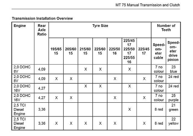

Just saw this onli a site says use red
That is about the worm wheel. It says to use the 21 teeth green cog. The wire colours from the VSS don't matter. I got the green cog from the dealer, wasn't that expensive.
