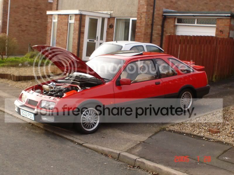

Its a red 1984 2.8 sierra XR4i and was standard when he bought it ... a few yeas ago!
And was in a very good condition to .. with 2 owners from new .. still had the toolkit in the boot and was like new!

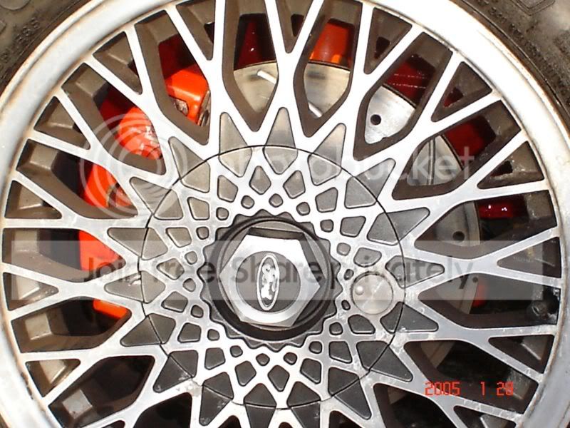

new 3dr cosworth bonnet from fords! grill and 3dr cosworth wheels where bought from PJ motosport!
New uprated and lowered shocks and spring where fitted! its a System 2 Suspension -25mm!

sorry old pic crap i know But! not looking to bad for a car thats now nealy 22 years old!

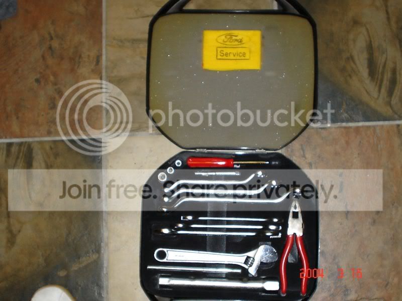

an original ford toolkit in top condition

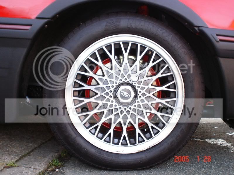

and um 1 of the 3dr cosworth wheels

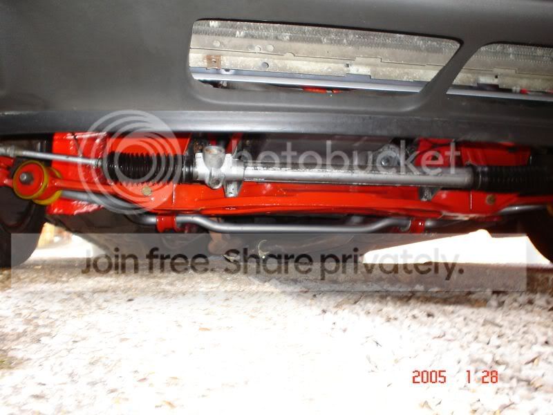

Then a 2.8 sierra 4x4 in a scrap-yard was found
The back-end was removed from it and taken home till we decided what to do.

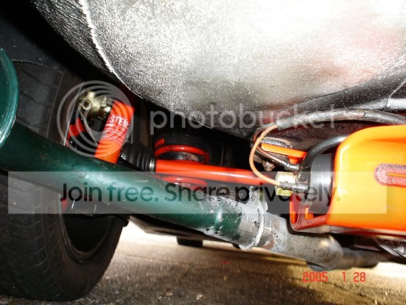

It was @ this time we decided to renew or paint most parts under the car..

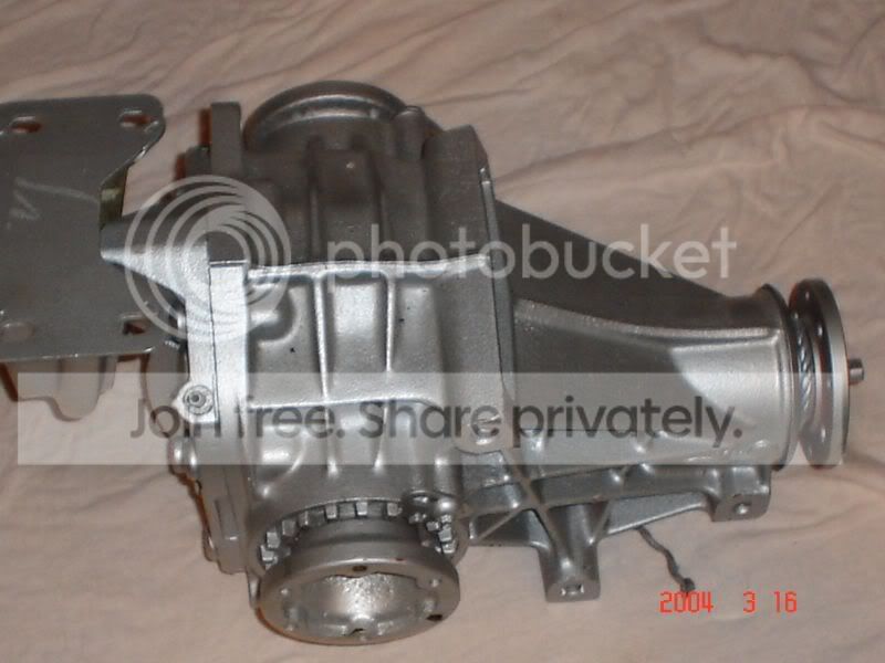

The back-end of the 4x4 from the scrap-yard was then striped down..

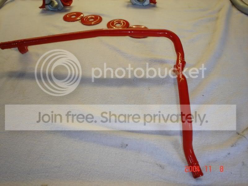

The rear beam and lower arms where then sent off to be sand-blasted and then powder-coated black the diff was pressure-steamed cleaned and painted silver..
The rear drive-shaft's and anti-roll-bar being shot-blast and powder-coated red
all new rubber-gaiters for the driveshaf's are on order .. as are a full back-end set of polly-bushes ...

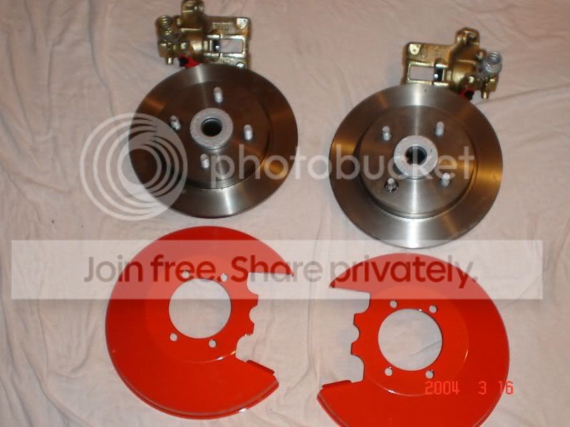

2 new rear brake Shields bought and powder-coated red ...

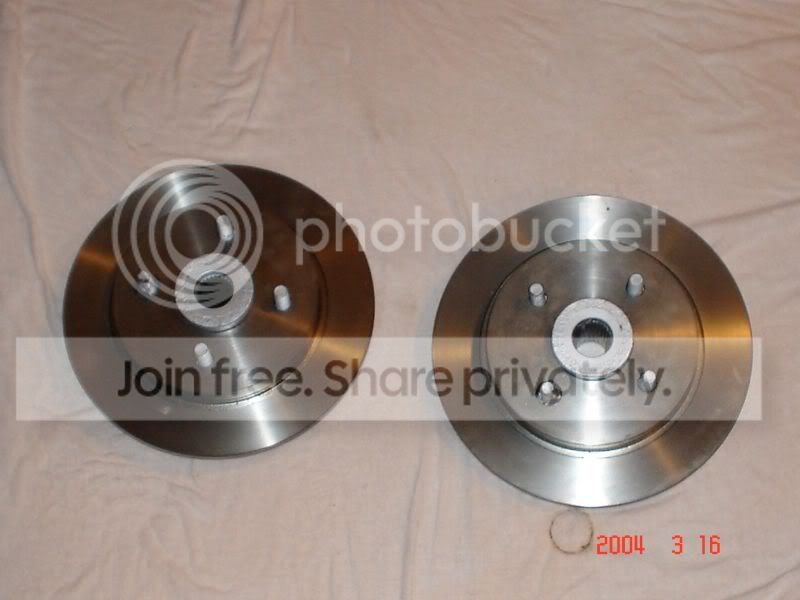

2 new rear disc's bought
2 re-con caliper's bought soon to be panted red

The fuel pump holder was removed shot-blasted and powder-coated red

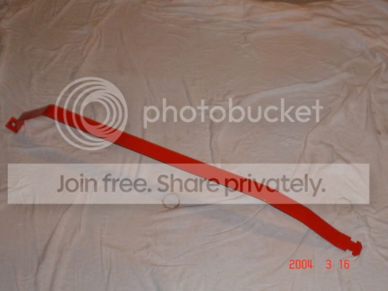

Fuel tank removed shot-blasted and power-coated silver .. the strap on the tank was powder-coated red ..

Thats stunning,what mine should look like! Have you had any trouble mounting the rear anti roll bar? I fitted a 4x4 rear end to mine and the rear anti roll bar fitting on the arms were different to that of the xr4i.Unless you can find a mk1 xr4x4, i believe theye the same. I had to cut off the 4i fitting and weld them to the 4x4 axle.

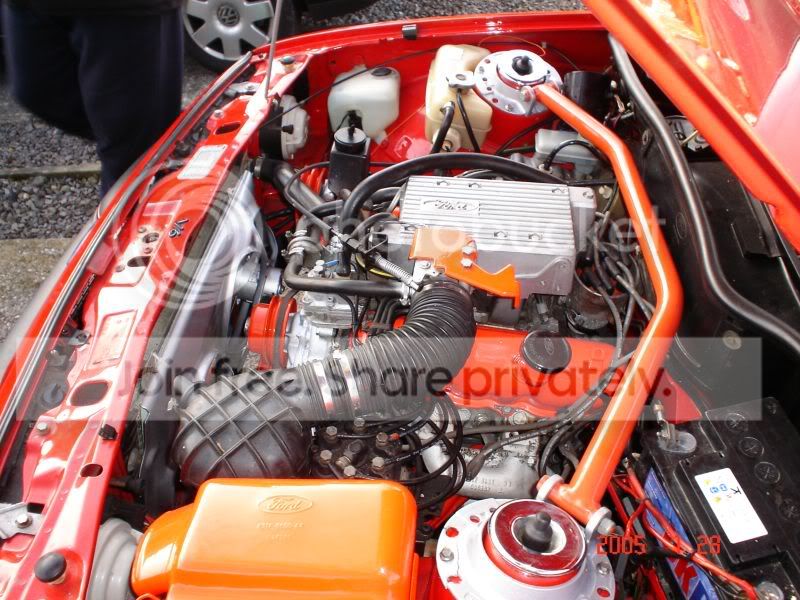

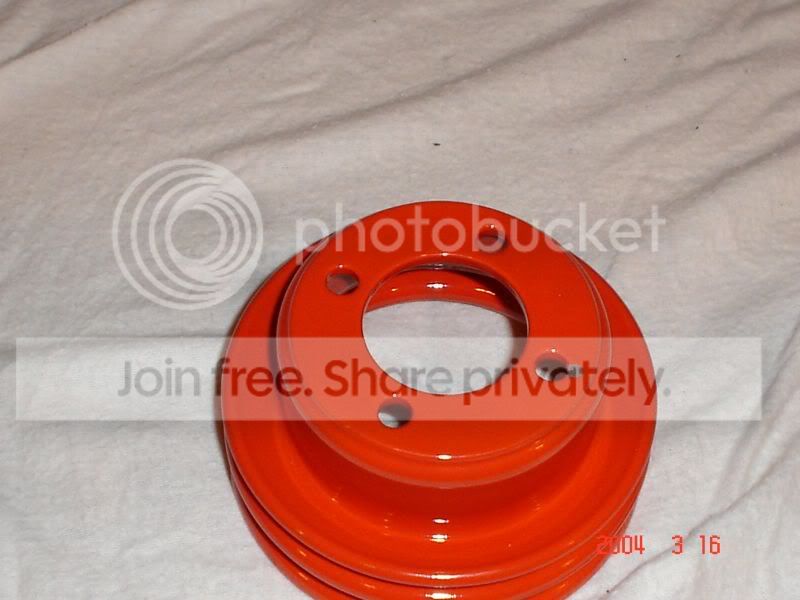

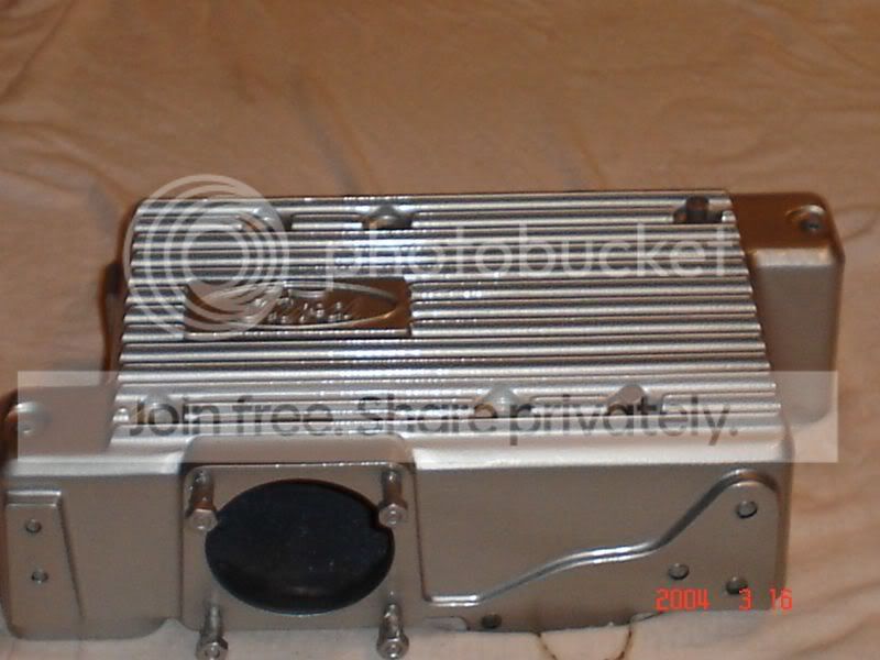

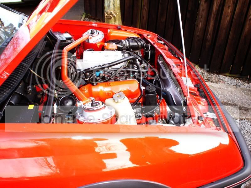

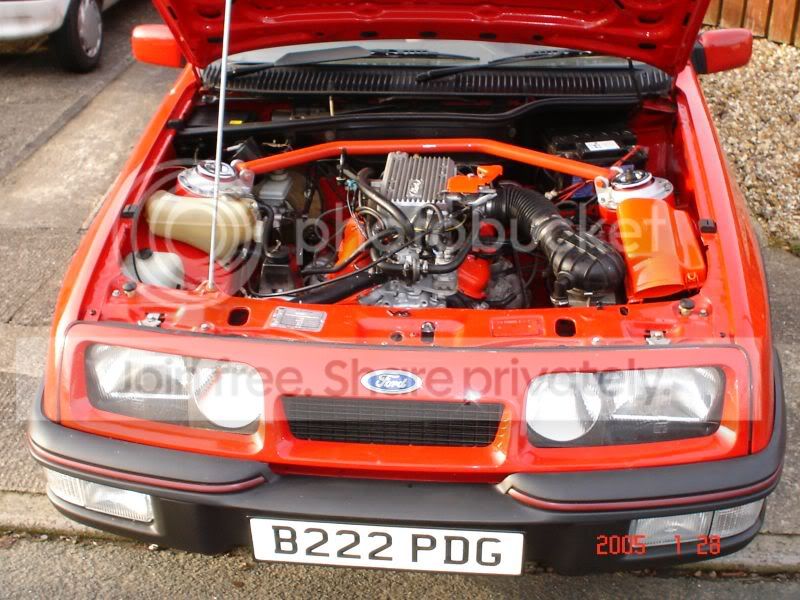

engine pulleys, thermostat housing , alternator bracket. power steering
braket. air box lind . damm he likes red , rocker covers .
air chamber, twin fans will be going on the car ,
started to fit some of the engine bay parts on, fitted the pas of the 2.8 4x4 as well , his XR4i came with out it, as it was a option on the 4i, hes still got more to do before the engine bay is done, but hes in no rush.
what you all think, looking worth all the work >?
