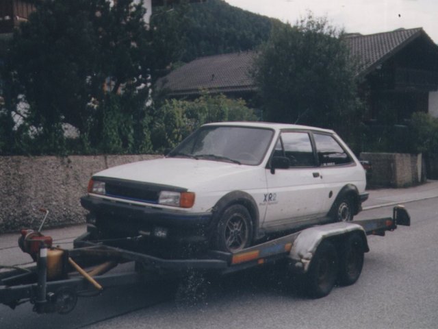

The dream of the Fiesta driving began in the 90's in form of the
Fiesta 1,1 of my grandmother.

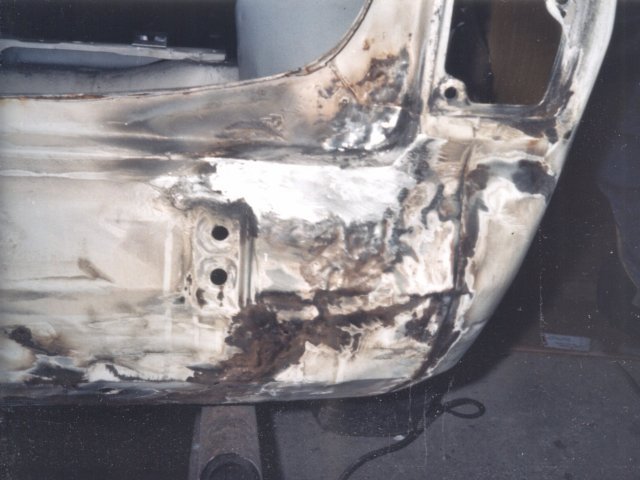

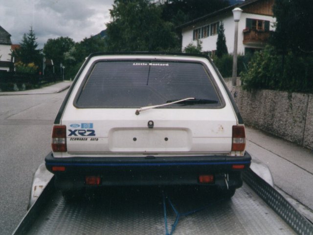

At this time a vehicle like the XR2 was too expensive. So some years later my first car became an Opel (Vauxhall) Corsa. But due to an error of the insurance company so very much money remained. And half a year later I bought this XR2:
The bad condition of the vehicle could not hold me from my project. After a thorough restoration the Fiesta was back on the road in 2001.

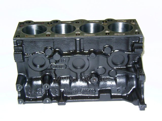

During the season 2001 I felt a desire for more power.
The carburetor engine ran simply too bad for my taste. I grew up with fuel injected engines and my carb'd CVH wasn't willing to rev neither had it enough torque on low revs. So I thought abouth the XR3i MFI. I wanted to use the engine from a Escort RSTurbo first, but the regulations about engine modifications and increase of hp are very strict in Germany. The installation of a turbo engine apart from material costs for engine, appropriate brakes etc. would have caused large problems and high costs. I just didn't dare to do this modification. Today I regret this a little bit.

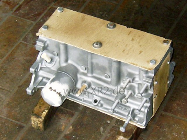

The engine was replaced winter 2003/2004 with my old XR2 bottom end new built with polished and ported head, solid tappets and a 308° camshaft.

some of the new parts i bought:
König K320 seats
and some other stuff
Sony head unit, amp and CD-changer aren't new
But Ford RS HT leads, blue injection lines, Folia Tec Midnight Reflex, SPAL fan, some hoses, front tie bars, anti roll bar rear, connectors and mounting parts for the rear anti roll bar, genuine Focus RS shifting knob
Strut brace rear, brake valves rear, blue KentCams vernier pulley, PU bushes
ATE PowerDisks, white KONI springs
red pagid pads
take a closer look

... wake up little bastard!
It's time for a total rebuild!
today early evening:
one or two hours later:

Interior's getting better day by day :P
Took the hood off
emptied the cooling system, took off the inlet manifold, emptied the fuel tank, took the rad out and the wiring loom is nearly disconnected
