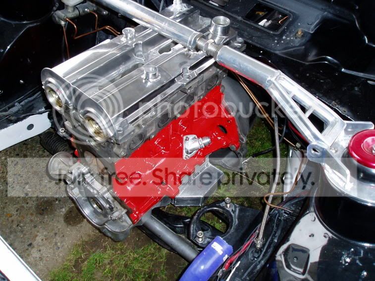

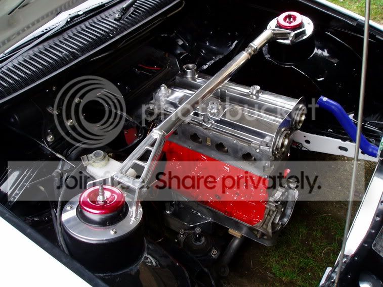

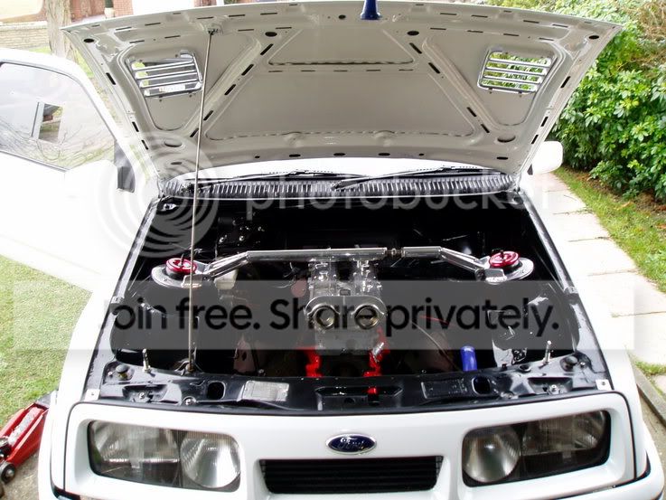

You had better pull your finger out as Col is really cracking on with his car.
As far as i know i think he might beat you to the title of worlds first 3dr zetec turbo????
Does any one know of another one?
Dan, here are some teasers

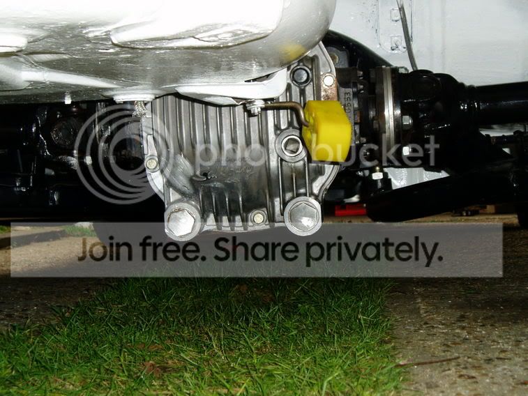

10.5" Jag rear diff to take take the power from its new engine.
Dan, got your dash in yet? Should look like this.

Looking good WHat power is it planning for then?
Thanks, 400 bhp is the target, but we'll see.

what engine mounts you going for?
i got some 1.8CVH ones from a saph
also, what inlet and zorst manifold you using?

Originally Posted by fudgeass
you pair of complete bastards
i got the pistons and rods now, but ran out of cash for the enigne build
looking good there mate, what sump is it your using?
a 2.0l one chopped and winged??
Sorry mate.
Yup totally rebuilt 2ltr item with big wings and baffles.
Bespoke everything.
Mounts are being made as we speak. We had a bit of a brainstorm about them when i took these photos this morn.
Inlet is nearly finished. New alu one with internal trumpets. I came up with the design for that one and Col has done a good job of fabbing it.
Zorst is yet to be made, but we have some plans. It will be tubular, externally gated and ceramic coated. GT30 will rest on top of it.

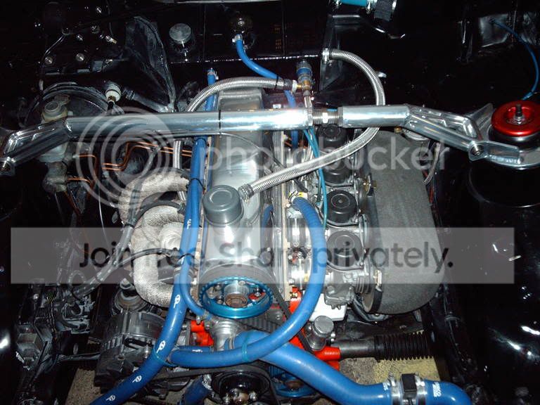

Originally Posted by Bradz
What did he do with the old engine /carbs?
Sold them onto a chap with a Robin Bastard... I mean Hood kit car.
