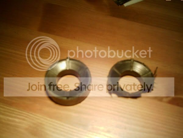

after changing mine last night I thought I'd give you an idea of how bad they can get.
they only cost about £5 for all of them as well, plus one of mine was actually missing
if you can grab the wheel and move it up and down chances are yours is knackered too
It took me about an hour in total to change mine, surprised how easy it was

mine were a little worse then the picture at the top of the thread... the steering wheel actully locked up due to the fact that the bush completely collapsed.
when it did collapse i was doing 70mph approaching a round about while eating a twister ice cream at about 2 am , the car wouldnt turn so i shit myself hit the brakes locked up and went across the round about side ways.
when the dust settled there were a load of young lads walking across the road.. they all gave me a round of applause for the spectacular spin.
ford did say 1 of the bushes were obsolite... but i managed to get second hand ones ok, once u change them the car drives like brand new.

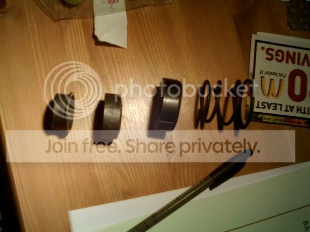

can anyone post a step by step pic up of these being fitted?
Just got all mine say here with that diagram from above and I haven't got a clue how they all go together lol

thats the ones I bought yeah, but just taken mine apart again and it looks like I'm missing number 10...
I'll try and take a trip up to a scrappy 2moro and get some pics of how it goes together

number 10 is on the bulk head mate where the steering colume disappeares through the bulk head.

I was going to say, its a rubber gaitor isnt it?

ah right so I'm not missing it then
thank fook for that
I think I've figured out how they go together from that pic now...

yep thats right, i also put a smear of grease on the bushs

I haven't replaced mine cos they were fine, but i had the dash out so the column had to come out, and i too greased mine, good practice
