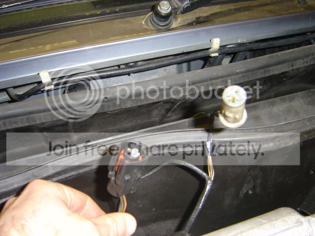

Hi anybody know where these muliplugs connect to on a S2 ERST

white one speed sencor for gearbox and other should be for water temp sender at back of inlet

I think the white one is for an electric dipstick level. The S2 never came with these, but early spec ones had them on the loom.

Its an 89 on a G plate, and I've already connected the water temp sender on the inlet manifold, where abouts its the gearbox speed sensor???

The black one as stated is the coolant sensor, and the white one as also stated looks like a speed sensor plug, HOWEVER, MFI RST's dont use a speed sensor, do you have a fuel computer on board? I cant see it being this however as the fuel computer is not part of the main loom.

No I don't have a fuel computer, and does that mean the plug is just a spare if I don't have a speed sensor. I will check the temp sender but I'm sure i've connected that up

1 plug has a brown/green and a brown
1 plug has a black/yellow a brown/white and a brown
1 plug has a brown/red a blue/yellow and a brown/yellow
I have identified the two wire plug a temp wire (via haynes manual)but can't see where it plugs and as for the other two I've no idea

No wind up mate, when I went out to have a look I found another one and no it isn't yellow thats the abs belt break switch isn't it
Two are as in the photo the other is the same shape and size as the white one in the pic only its black

as you said the one is the coolant temp, the white one IS a speed sensor plug and im still researching the black one, i would of said fuel flow sensor but the colours are wrong. Where abouts is the black plug?
Just checking your car is an MFI turbo yeah? Not EFI?
Old Dec 19, 2005 | 10:14 PM
aldy's Avatar
aldy
Posts: 113
From: Cambridge
its next to the white one up by the heater box and it is MFI not EFI

I'll keep looking, for the mean time though i dont think they are anything important, that additional coolant one doesnt appear on all the cars for some reason??? Not too sure why, don't worry about it though its a secondary one you still have the primary one.
The important plugs to have connected are the coolant temp, hydro electric pressure actuator, throttle switch, air charge temp, air flap position sensor, and the amal valve (if ur running one), all the rest arent crucial.

Thanks for your help I have all those connected up so if the others arn't important I'm not worried. Hopefully should be up and running over the xmas break (kids,missus permitting)
