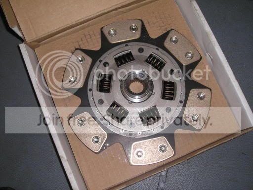

been built for a while now it's looking metal can't wait 4 it 2 be fitted which is happening soon ha just in time 4 the worst bit ov winter lol
got a massive spec not really any mad trick bits like some have been doing now but a very solid reliable 450BHP capable ov 550BHP
engineered by julian goddfrey built by tremona garage to a very high standard as u can see and will be live mapped by pj's once run in and management choosen[/img]
more pics 2 follow

some ov the spec
brand new block from rod tarry bored to standard size
fully lightened bottom end and balanced from front pulley through 2 the pressure plate -julian goddfrey
new ceramic coated pistons low comp 7.2-1 with valve cut out
wingage tray under crank
big end bolts fly wheel bolt + clutch bolts all arp
block is long studded wiv wrc mutli layer gasket
julian goddfrey baff sump wiv oil gate
all engine parts powder coated arranged by tremona garage
head is from cylinder head developments as follows
16 new valves ,guides vavles and seats polished ported to grp a spec inlet manifold matched to head new bd14's from blanks new hydraulics tappets kent vs double valve spring kit new kent verniers kent manifold stud nut kits all at cost ov Ł2800 from chd
brand new rocker cover
complete new engine bolt set supplied by tremona when they built this engine
all gaskets cometic
turbo is t34 stage 3 from A1 rally on a 4x4 manifold
gonna check reciepts to c if i've missed anything i no i ave
