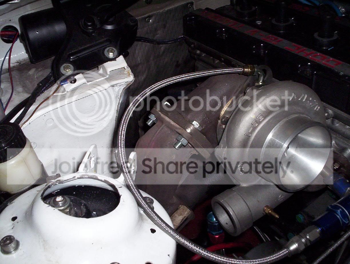

Looks fooking awsome m8 What size is that turbo ? T38

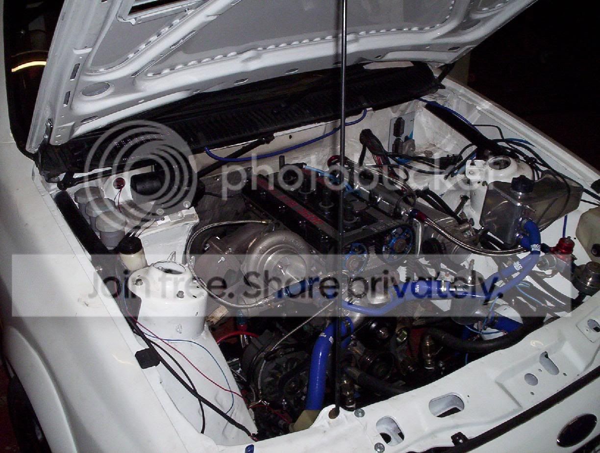

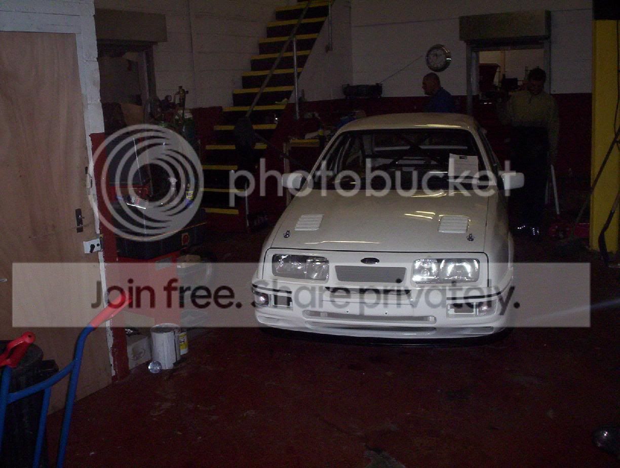

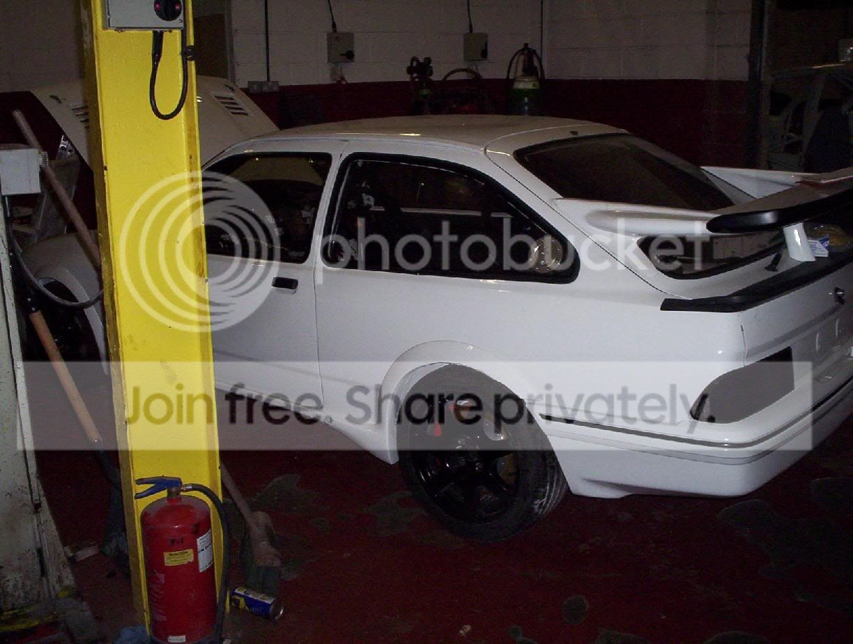

Anyone know why brom moved the engine back
Old Jul 6, 2004 | 12:15 AM
slowpoke's Avatar
slowpoke
Posts: 5,807
From: huddersfield
the further back the engine is the better balanced the car is

T38? Hell no! T foookin HUGE!
Tis a GT40 i think...
Engine moved back for far better weight distribution
Old Jul 6, 2004 | 12:17 AM
CozzyBrom's Avatar
CozzyBrom
Posts: 5,391
pete the new tiff on posting
car will be driving this weekend been buzy with other stuff not had chance
i moved the engine back to make it mid mounted the engine sits behind the front wheels now
also make it handle better i got 50/50 weight split even before its got fuel and me sat on the back axle

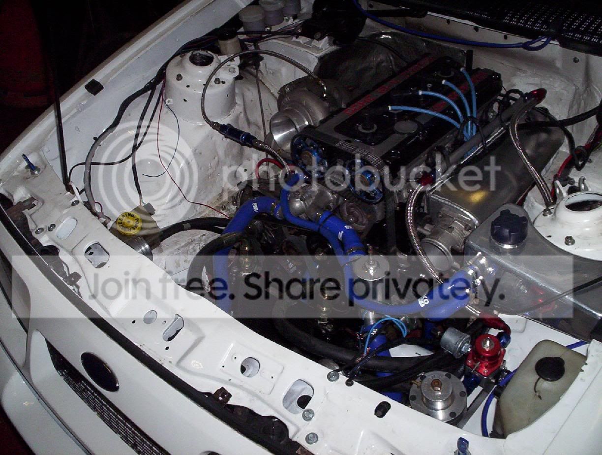

Just notice Brom, what u doing about an exhaust?
you gonna make one yaself? heard u the master at making custom stuff up

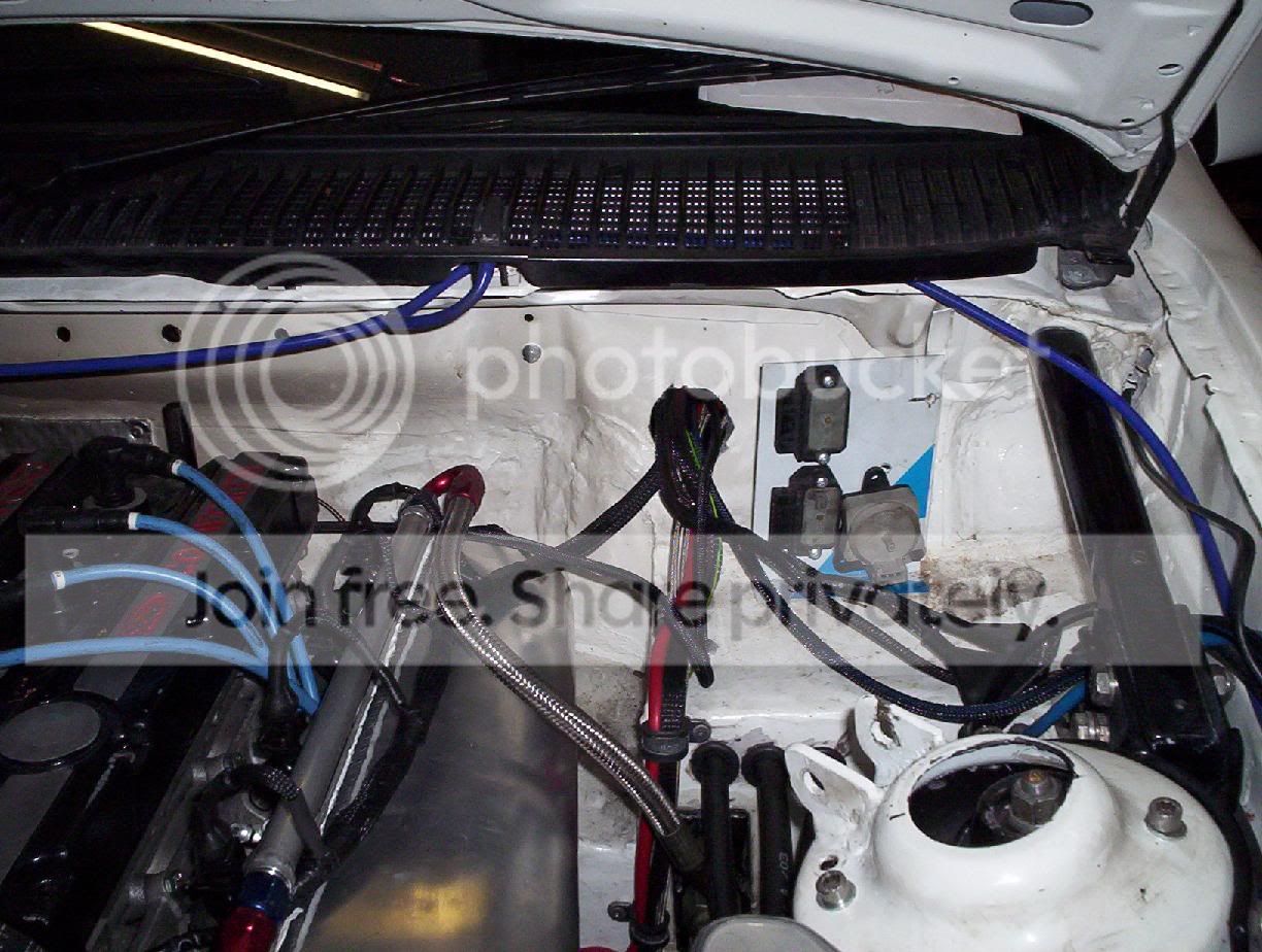

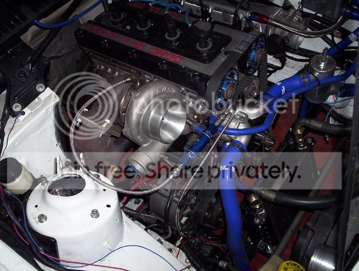

Brom, you not going dizzyless ign?
Old Jul 6, 2004 | 12:28 AM
CozzyBrom's Avatar
CozzyBrom
Posts: 5,391
err yes steve am on coil pack y
you just carnt see it
am on s8 ecu with all the bling bling bits
including the 1000cc msd fook off injectors

coooooool
thought you would, jus the way the plug leads were heading in the pics i thought u was still gona use a shoddy dizzy!
what power you thinking? 600 or so?
or more?
absofookinlute monster whatever
Old Jul 6, 2004 | 12:35 AM
CozzyBrom's Avatar
CozzyBrom
Posts: 5,391

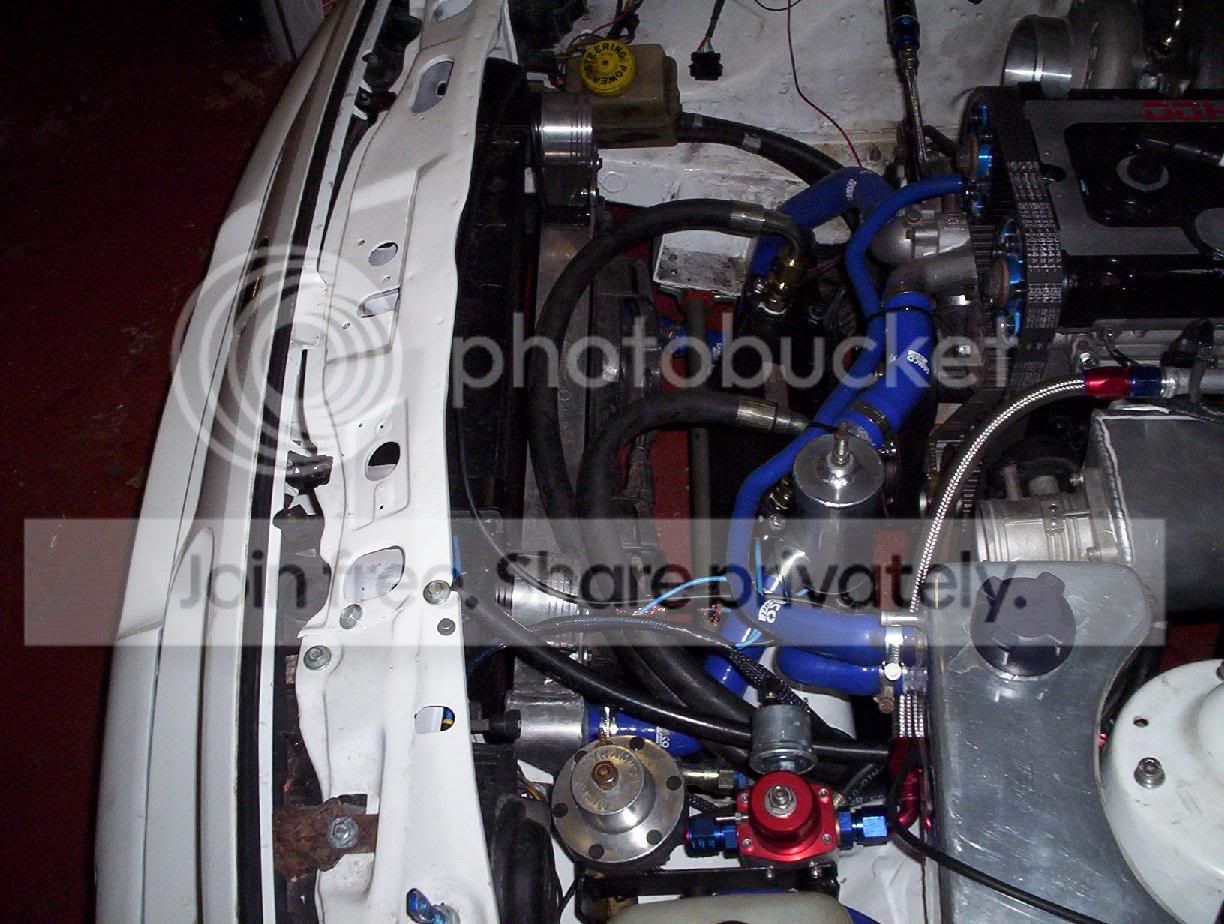

well 600 will be nice
shes gona rev so all good lots of nice farndon bits in there
but ontop of that i got 180 shot ov noz aswell direct port fogger set up same as danny b set up
Old Jul 6, 2004 | 12:37 AM

it runs its own fuel line and pump set up with its own reg to set fuel presure up corectly
using the engine fuel system is not the best idea as it has rising rate reg which throws the fueling out on the noz
danny said the nozzles we use wud go up to 300 shot per cylinder thats 1200bhp of noz
the coil pack it bolted under the plenum out the way and keeps the bay all neat and tidy
i dont like pics like this as it looks a right mess at mine will poost pics up when its fully on the road

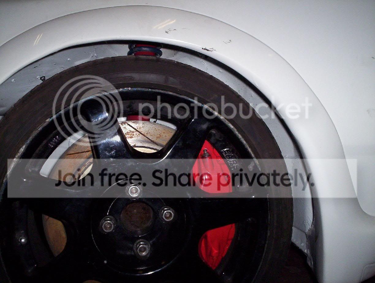

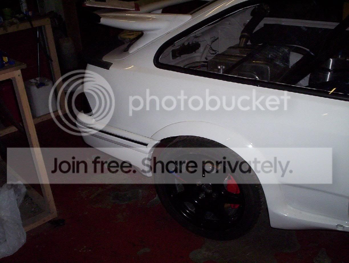

How much negative camber are you running?? Looks like a bunch!!

ha ha eric
not running any neg camber just had car up on jack so suspensoin hasnt settled
