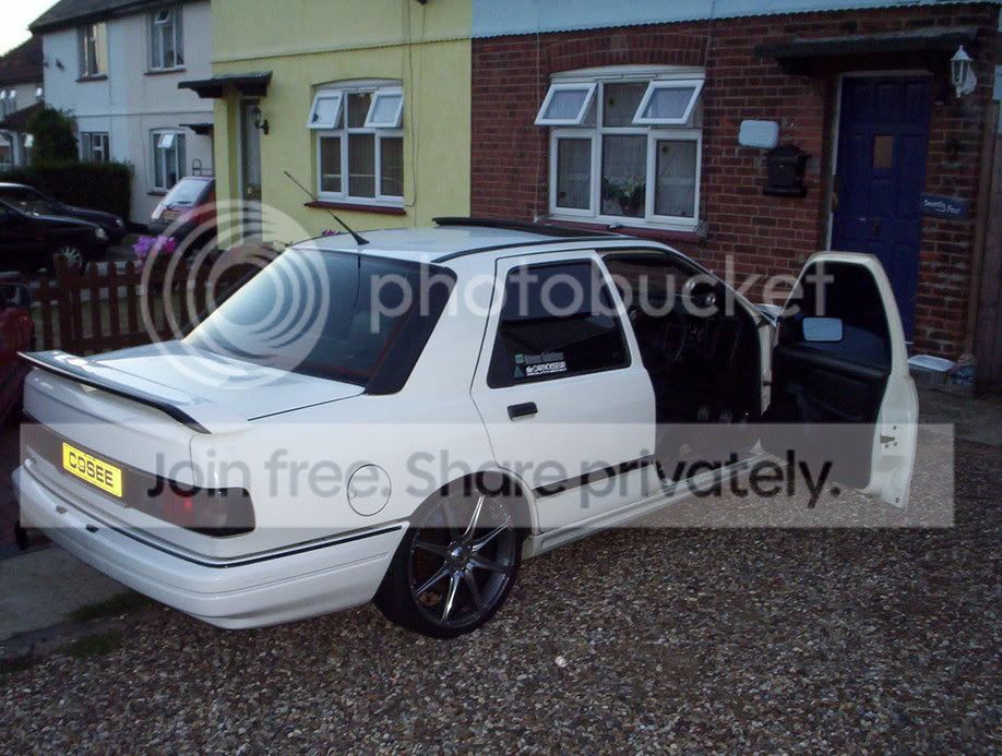

ITS A STANDARD LOOKING WHITE SAPPHIRE WITH TINTED GLASS AND IT HAD BIG AFTERMERKET ALLOYS ON IT,BUT IVE PUT 18" COMP MO'S ON IT NOW.EXTERNALLY IT ALSO HAS HI SPEC BILLET FRONT BRAKE DISC CONVERSION.I BOUGHT IT OFF A 50ISH YEAR OLD FELLA WHO DIDNT SEEM TO KNOW TOO MUCH ABOUT THE SPEC,BUT HE PAID £8500 FOR IT LAST YEAR BUT HIS AD WAS JUST A COPY OF THE ONE HE BOUGHT IT OFF.....

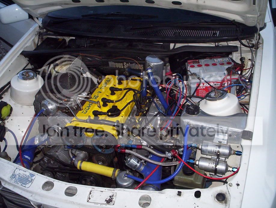

ITS GOT TWIN FUEL PUMPS WITH THE TWIN FILTERS UNDER THE BONNET AND A NITROUS KIT RUNNING AN INJECTOR INTO EACH PORT.
IT LOOKS DIFFERENT NOW AS IVE FITTED TWIN HEADLAMPS AND THE ALLOYS

200 block with knife edged crank,low comp pistons,bd14 cams,double valve springs,ported head.it has siamesed 8 injector inlet manifold.direct port nitrous shot of 75 bhp.pectel loom with p8 management

oh yes and it has a t34 turbo and a big intercooler rs500 size but looks heavier duty.

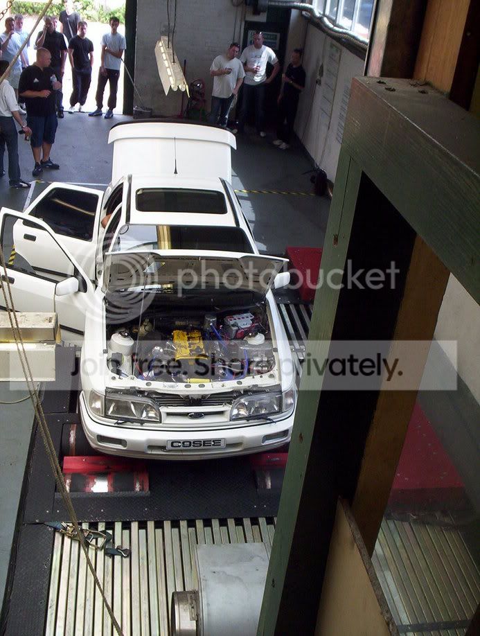

Mate i spent 25k on that motor and built most of it myself the als use to work fine that is what the red switch is for but i changed the tps on it before i sold it and never put it back in the right postion!. The car needs remapping it was overfulling a tad as of the tps etc. you need to have it mapped oh and she use to detonate to fck when i used the nos it also needs to be mapped in!!

Remember you at the rolling road day. And remember it made well over 400bhp, even with the Nitro's leaking all over the engine bay.... Would have done even more without the leaks.
