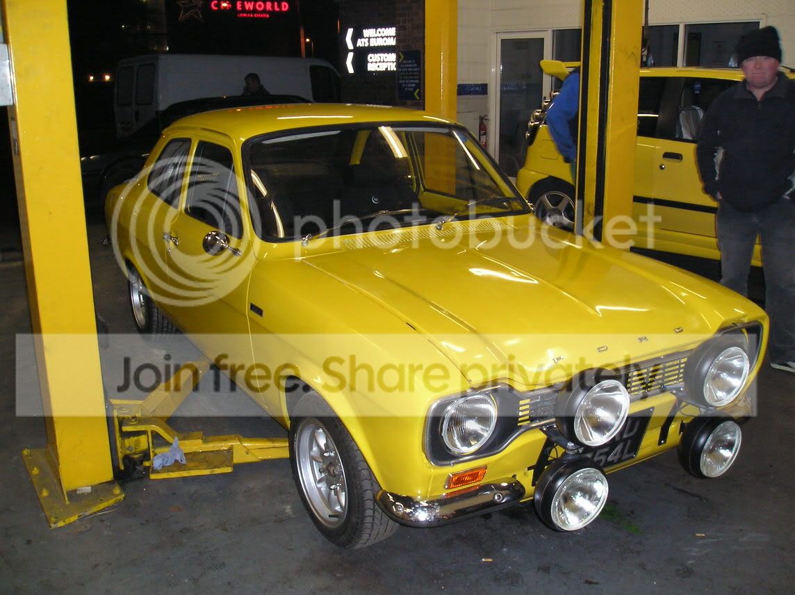

mk1 mex being converted to cossie power. car has had new floor pans in the front, new wings, new front panel and slam panel. full respray in ford yellow.
[img http://i22.photobucket.com/albums/b311/mbeblue70/mikesmk1escortcosworth004.jpg[/img]

Looks like a lovely car mate - keep us updated with pics as it gets put back together
Is it going to be used on track at all? Will keep an eye out for it at the shows next year

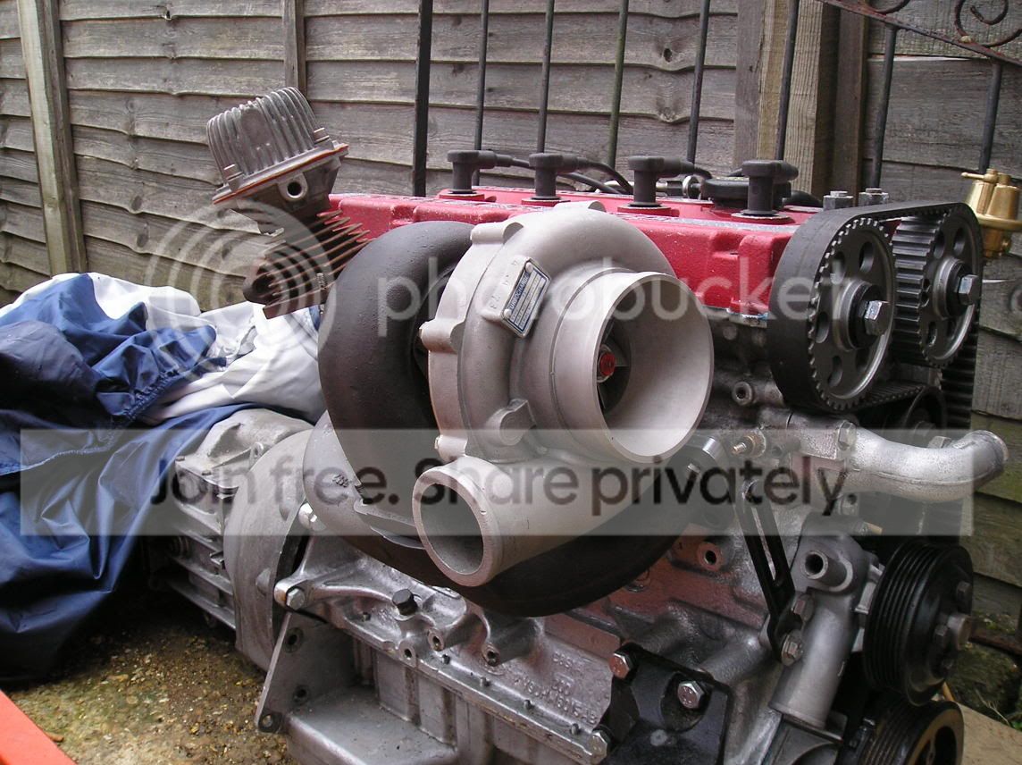

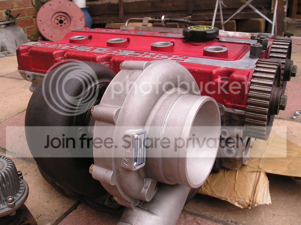

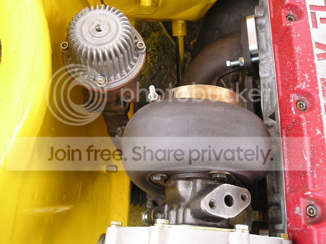

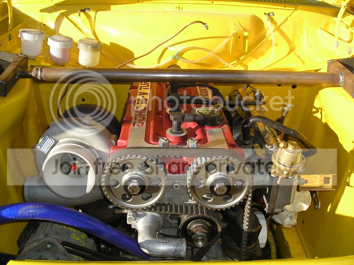

the engine 200 block 1mm oversized pistons lots of new parts in it arp stud+nut kit wrc head gasket now we get 2 the TURBO IT ONLY A BABY ONE HA HA garrett super t70 84 ar exhaust housing twin roller bearing with external wastegate can take up 2 650bhp but i will be running about 400+bhp on greys and 4 the SANTA POD DAYS 100bhp nos kit

turbo looks like an ebay job to me, be very very careful, i bet its not what they say
a real t70 would be rated to anything up to 900bhp for a good one, most are good for over 800, never seen a real t70 rated as low as that.

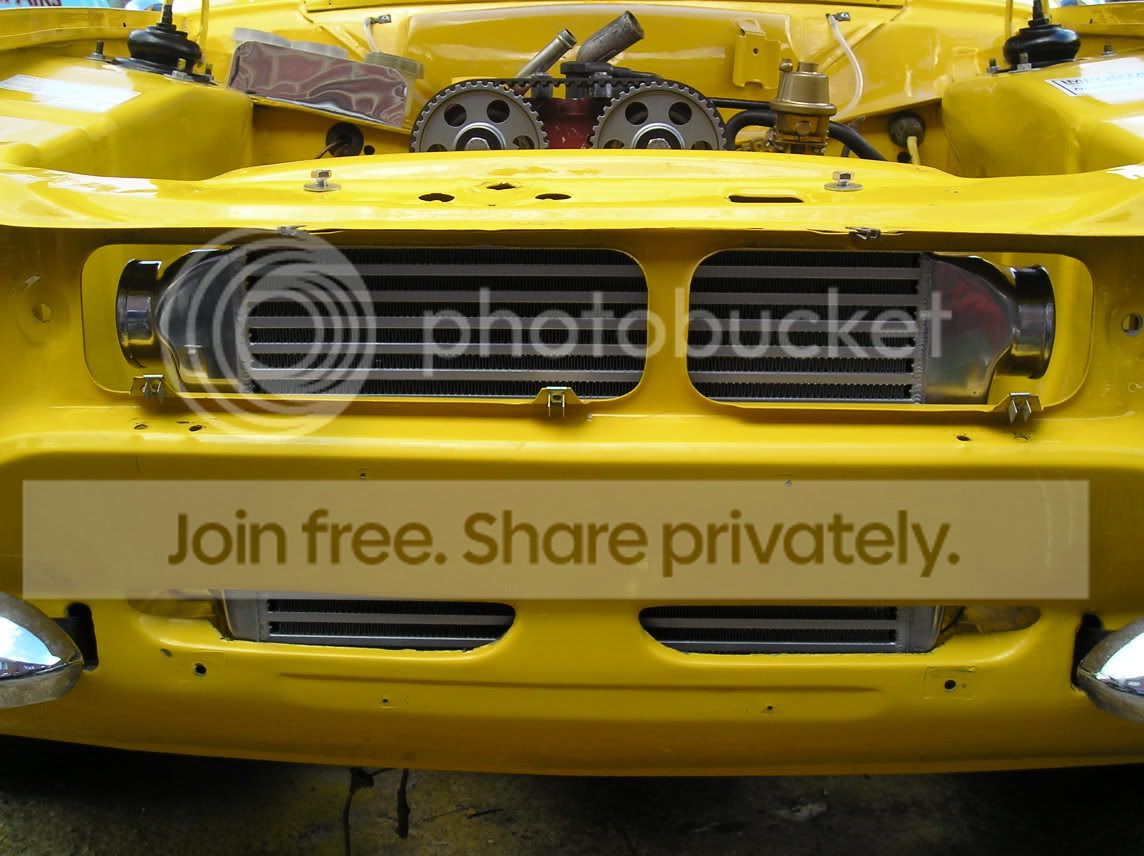

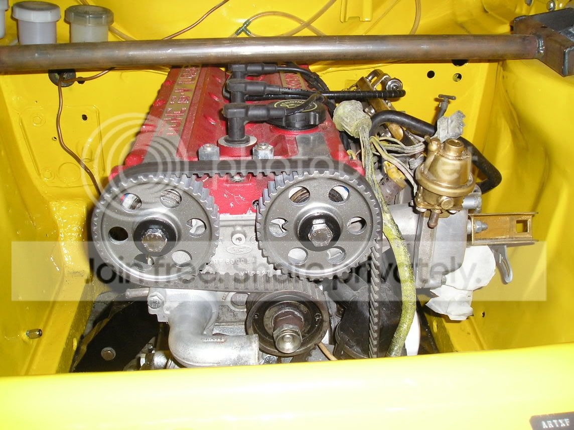

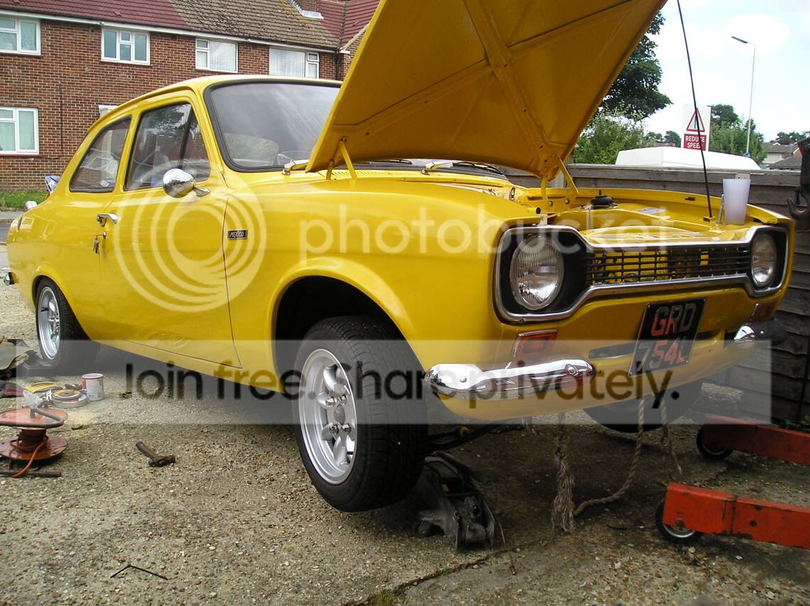

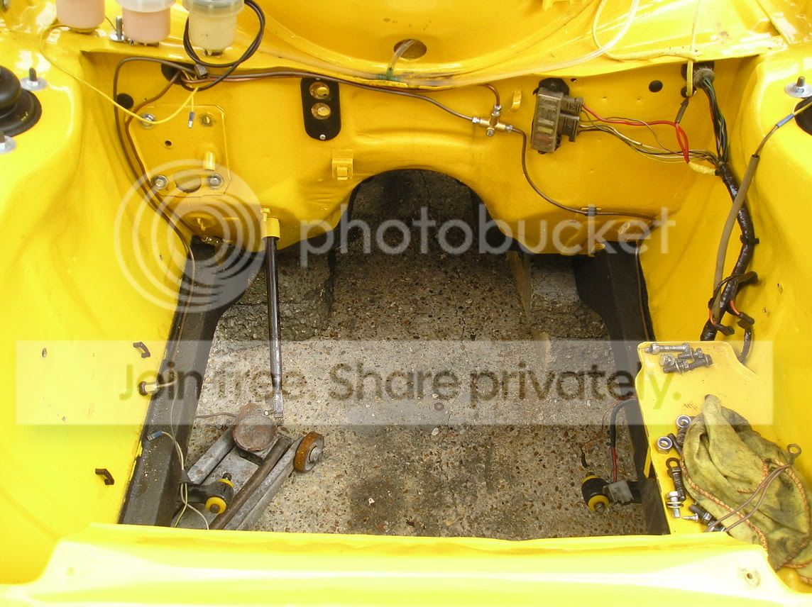

just fitted engine and gearbox next step making external wastegate pipe and fitting the exhaust and fitting my little intercooler??

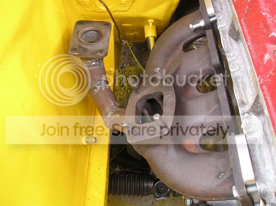

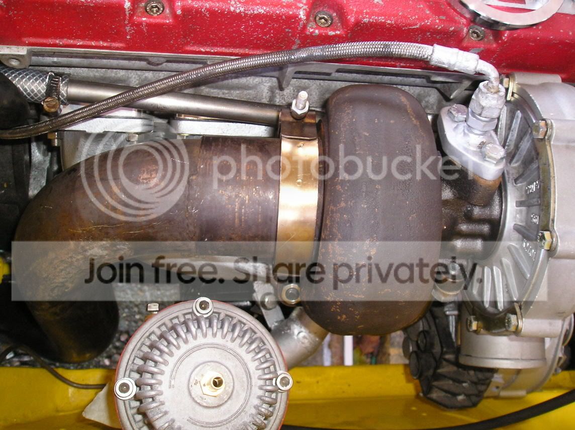

just put on a few pictures of the manifold with the wastegate fitted after i was playing around with the welder. only took me an hour to make the wastegate pipe and weld it to the manifold using special arc rods. the hardest part was getting the hole in the manifold

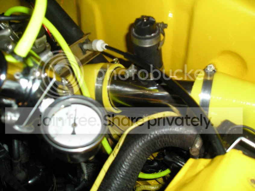

Old Oct 11, 2005 | 04:51 PM
mbeblue70's Avatar
mbeblue70
Posts: 82
From: portsmouth

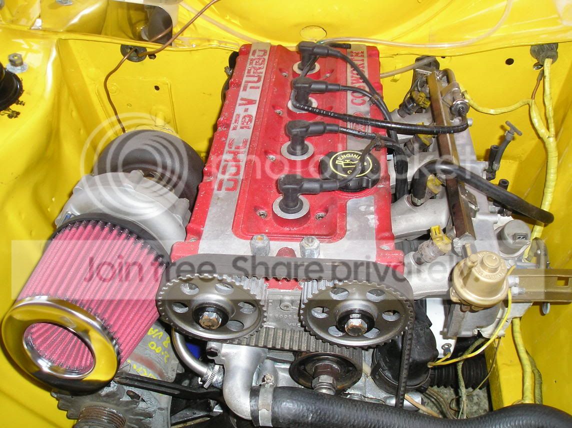

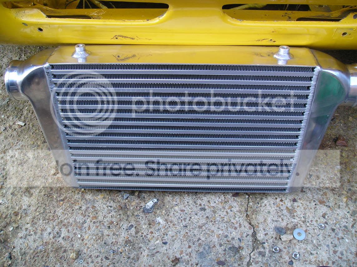

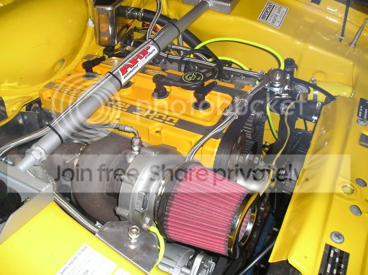

some more pictures of the engine and intercooler

looks nice m8 will be fun when that turbo kicks in you might wanna bubble it and get some wider rubber
Old Oct 12, 2005 | 12:23 AM
NEIL A's Avatar
NEIL A
Posts: 5,297
From: LEVEN , FIFE
looks real nice mate! where did you get the spacers for the exhaust manifold, good way of getting the clearance without going to a 2wd manifold.

got the spacers made by a friend of mine. he used an exhaust gasket as a template and had them machined out of billet alluminium. my friend has got a set left if any one is interested in them. there £20 plus p+p

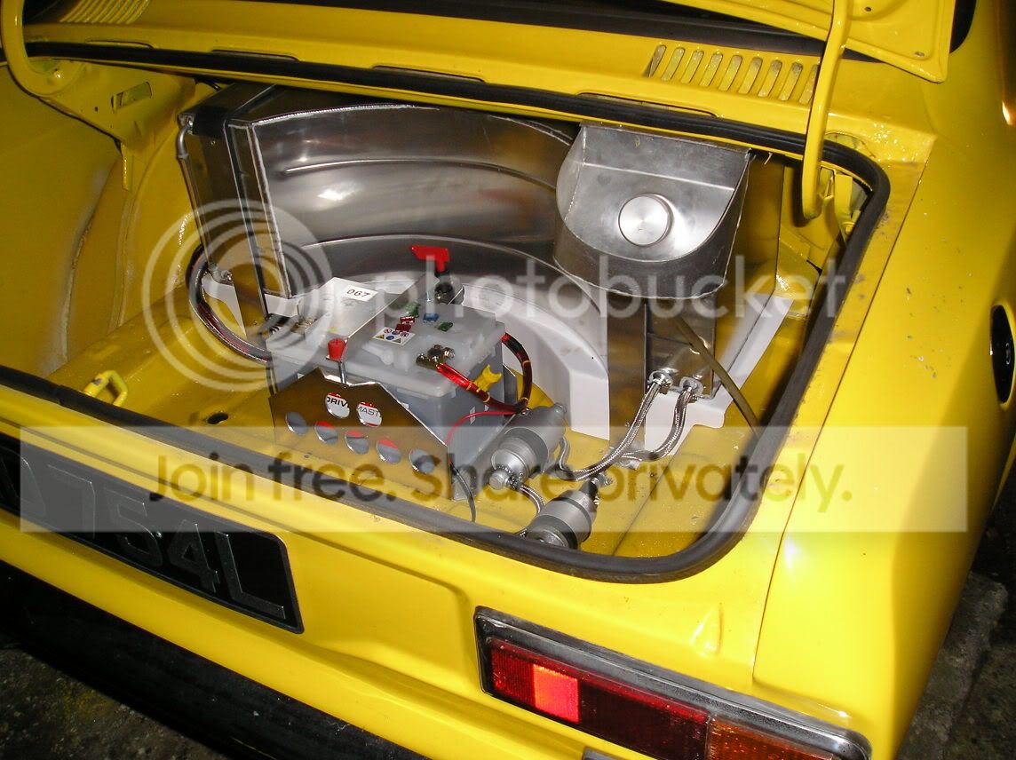

Old Nov 9, 2005 | 08:53 PM
mbeblue70's Avatar
mbeblue70
Posts: 82
From: portsmouth

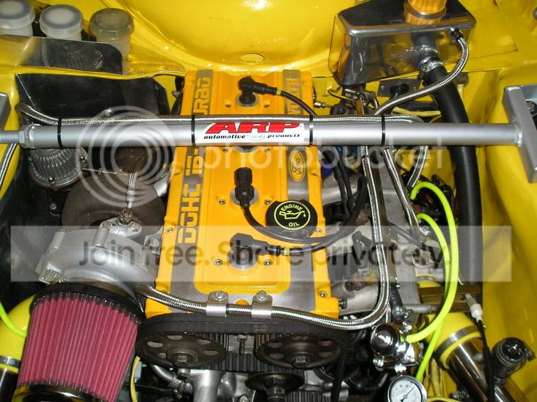

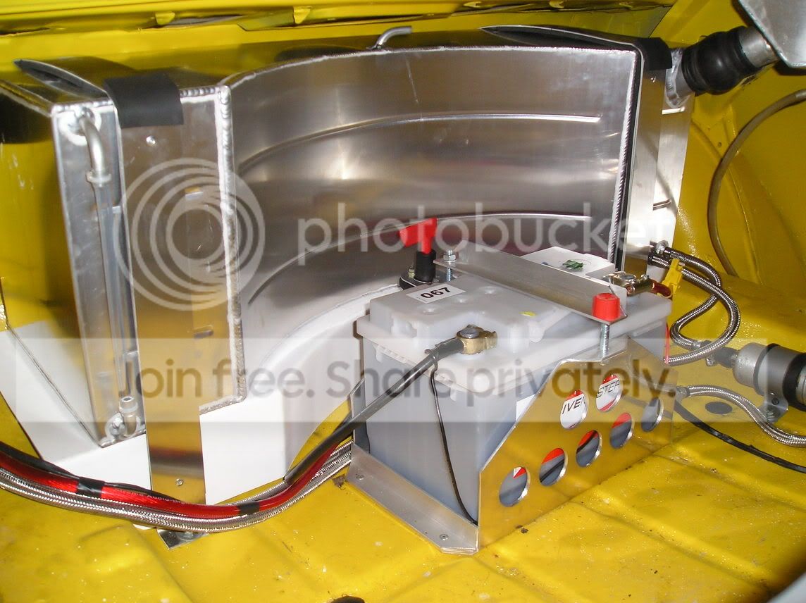

exhaust and fuel tank fitted.

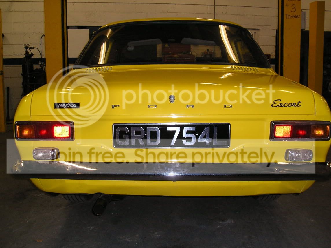

finally got the motor running. almost ready for mot. just the brakes and seats to get sorted

very nice mex, nice choice of engine
