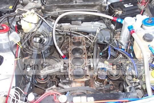

I spent 3hours this afternoon taking the head off of my 2wd sapphire cossie as i had lost water from the header tank into the sump and it started on 3 Cylinders in a morning. I took the head off and the YB0611 head gasket looked like it sealed all round on all surfaces, didnt look like it had failed at all, so I wanted to know where else on the engine might oil and water mix?
Could the turbo waterways crack (its a brand new turbo, done less than 100miles on it), there is an oil stain at the bottom of the housing though which is odd?? or could the oil modine behind the oil filter be knackered or?? Any ideas. I ran out of daylight but have yet to turn the pistons over and check the bores for cracks, the pistons have no rusty water stains or such like, the combustion chamber was just covered in oil too which is a little worrying too??

Seems the oil modine is fine, I just plumbed it into mains pressure and thats not leaking at all. I dont want to put it back on the car though, anybody doing anything different with their oil and water ways, I think PON did away with his Modine but i cant find it in a search? I had a look at the bores and they are clean, oiled and crack free where I can see so its time for the turbo to be checked and then maybe a bottom end rebuild??
Old Jan 24, 2005 | 08:49 PM
Mr C's Avatar
Mr C
Posts: 4,391
From: Leicester LE3
The engine bay went from this:
to this in 3 hours, really cant find that water leak
