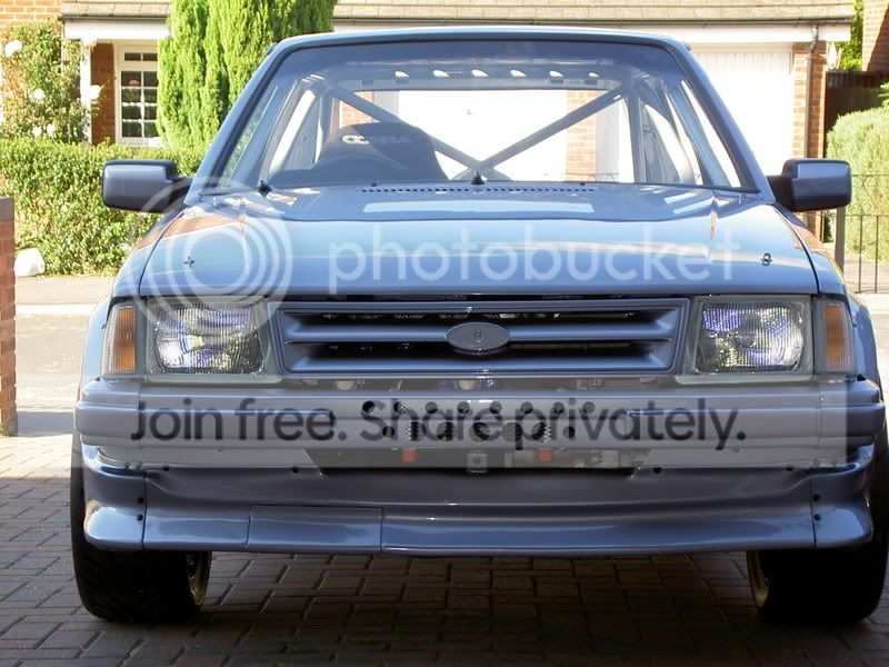

Old Sep 12, 2007 | 06:59 PM
gus's Avatar
gus
Posts: 10,507
From: essex
inner wings?
mine is in the bumper but then it fits perfect in mine (s1)
would you cut bumper?
