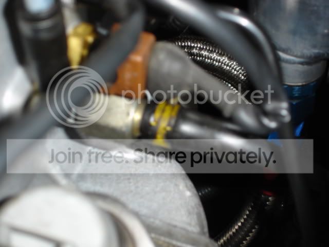

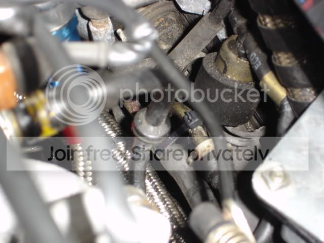

Can anyone tell me if this hose is connected up correctly?
Its on an Escort Cossie big turbo.
The large one at the bottom of the Plenum. It usually goes to the Std breather flame trap under the manifold but my car has a GGR Breather system fitted which dose away with this.
The only hose that i could find lying around after everything else was connected was the one from the Carbon Canister Solenoid.
Is this correct? if not where dose it go?
As always any help appreciated
Pics.
Pic of the hose at the Plenum. Its the one under the sensor
Pic of the hose i have connected it to
And a pic of the Solenoid that its going to

mines connected the same, so im guessing thats right!

sure the one on my first escort was blanked off.
not sure why.

Was it just blanked off at the Plenum and the hose to the solenoid left open or was that blanked off as well?

Pretty sure if its connected to the carbon canister set-up it needs to be connected to the inlet,then all the fumes from your petrol tank get sucked into engine through inlet rather than breathing to atmosphere which is what pre-cat cars do
Pretty sure thats right
yes you are

I *think* that some chips don't control that valve properly, so it might not matter where it goes (hence why it was left off?)
