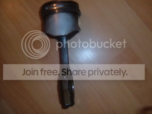

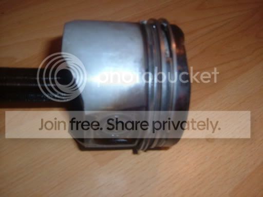

After having a shit RR figure and knowing that my frst was down on compression i decided to get physical with it... with help from manchester mike we stripped the engine down and found this...
I'm guessing that the chunck brocken between the rings caused it...
Now to sort it out... They are mahle +0.5 pistons, only seem to have any damage on one of them... should i change that one or is it better to change them all? also while they are out should I change the rings? they are pretty sharp, i've been told this is a sign of ware?
Also where can i get my hands on a +0.5 piston cheap, and do I have to replace with mahle or can i use something else such as AE?
Cheers in advance

p.s look for black det spots on the rings but there not expensive so be a good move IMO
Been lean or detin thats for sure.

22psi through a t2 on beige's and std cooler should give u some idea...

is the damage on the exhaust side or inlet side of the piston.. ???
Old Mar 2, 2006 | 08:41 PM
Tim's Avatar
Tim
Posts: 3,888
From: Derbyshire
looks like exh

Lol, easy to sort. Bearings are really nice, rings have no set markings, bore's are all good.

Can i just point out that it was runing that b4 i bought it!! It has been set up by MSD since

was your engine running seemingly ok though concidering what you found ? but with lack of power ?
Old Mar 2, 2006 | 10:43 PM
Sean_RS's Avatar
Sean_RS
Posts: 2,193
From: Manchester... Home of the Reds.
yeah fine... it was still producing just short of 150bhp but i obviously knew something was up and wanted to find out what and sort it.
