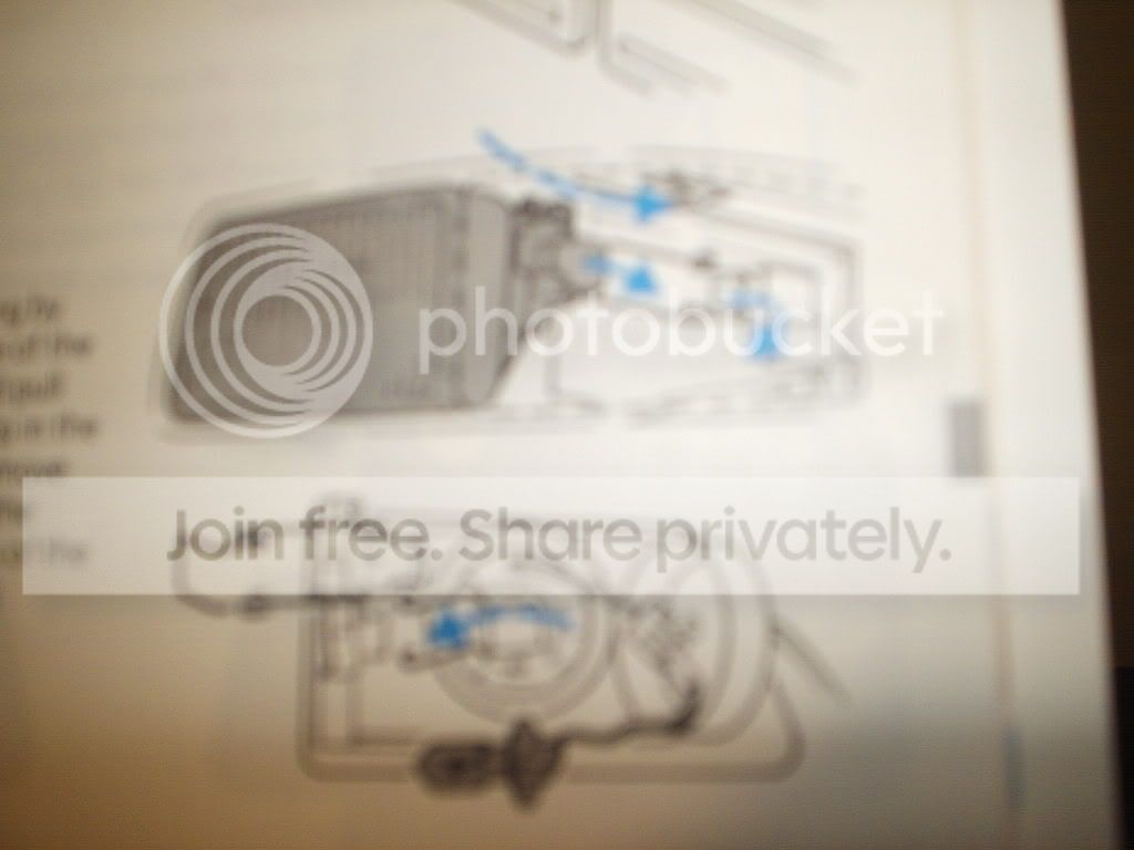

sorry about the pic the top blue arrow is the spring clip you need to push that up so you need a long thin screw driver or the like then the indicator will pop out. after that you can undo the clip on the fog light. then you will have access to the bottom headlight screw, there are only three screws holding the light in but there is a locating point on the headlight but that is just a lug on the headlight itself so once all 3 screws are out you wont have any probs

your a star mate, just got it off in one go without busting anythink!!! excellent!!! thanx for all the help from everyone on this!!, cars looking sad for itself now with no headlights and grill,
