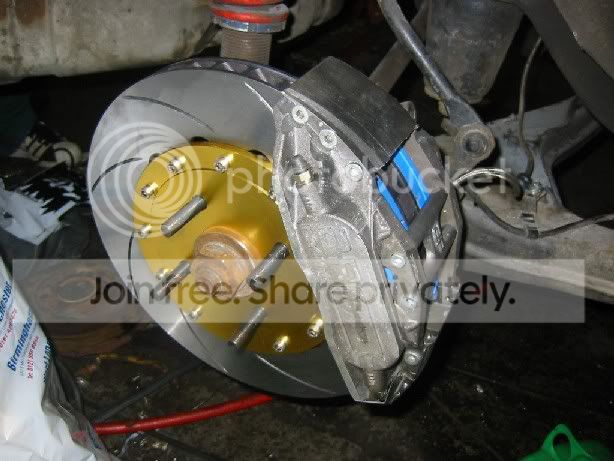

do it, that is what i have been up to here is a few pics for you, o the hand brake caliper takes some work you will need to make brackets, get longer cable and mod the ends and make a spring return and bracket set up for the cable as well

Thanks guys Duncoss thats the setup I am after.................
