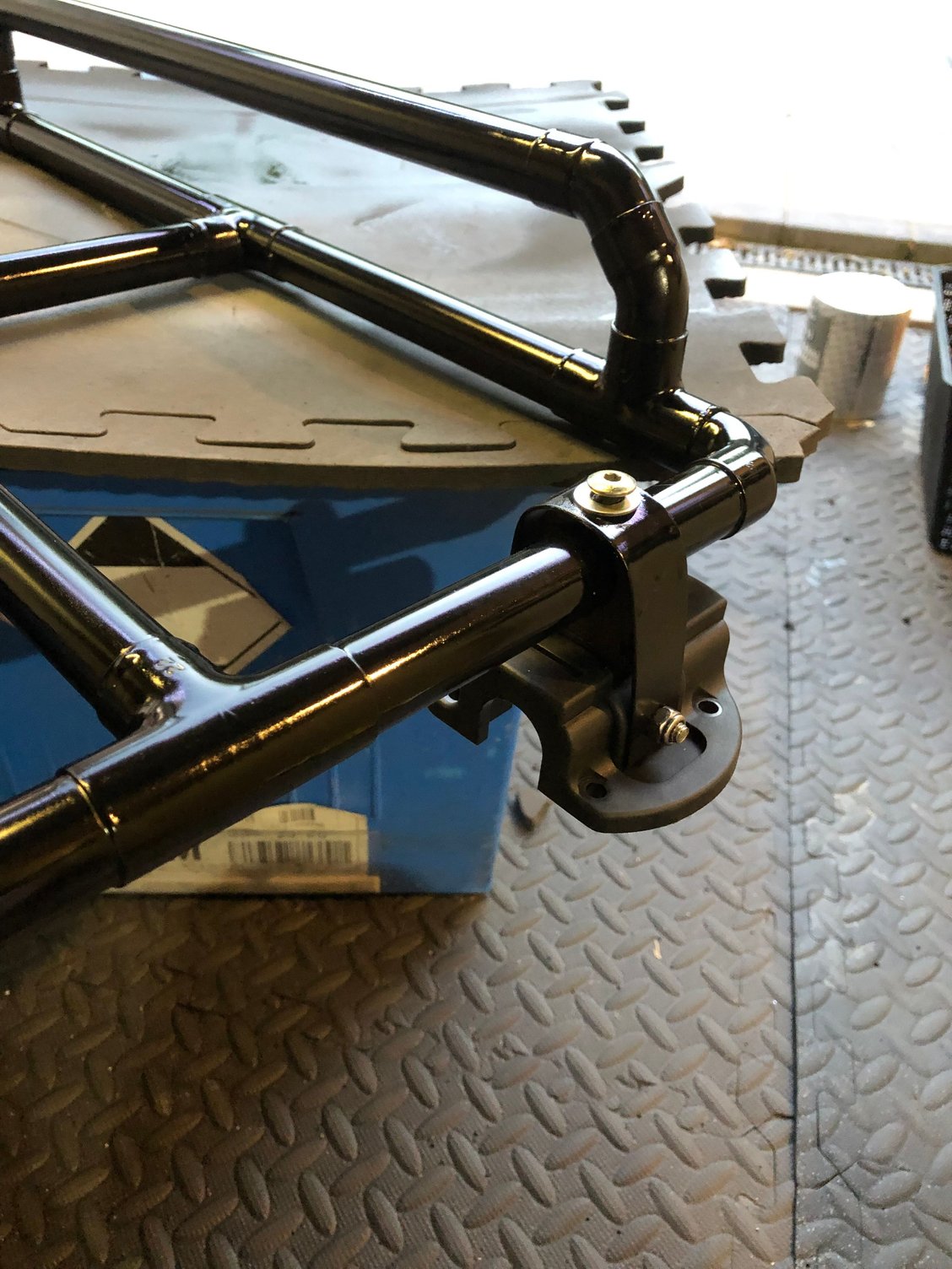

I then set about how to properly mount the frame to the cup, the way I did it to mock up was fixing to a riv nut type thing in the plastic. Although in solid I don’t trust it on it’s own
So I shaped some steel plate around the mount to secure to the existing mount holes on the side
