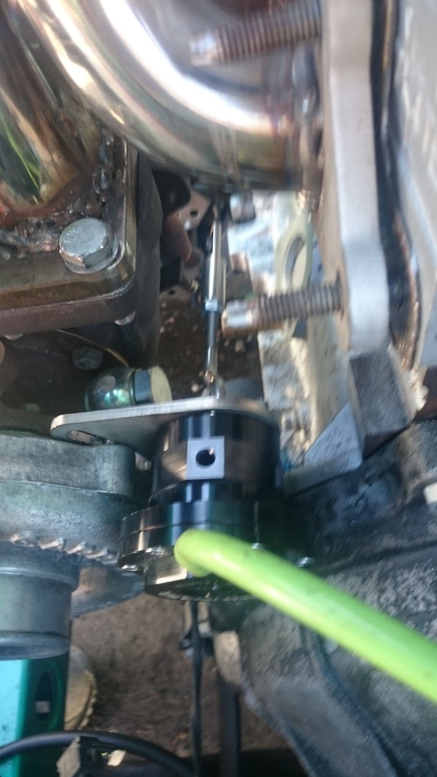

First problem bolted on my turbo to the manifold yesterday and realised I have bugger all room for my actuator, I think I could cut the bracket and turn it so it points the actuator downwards towards the penny flap.pin but not sure if this will give full.movement to it??
So my other option would be to not do this and fit an external wastegate set up and weld up the wastegate penny... What are people thoughts to either way?
This picture was taken with the actuator touching the gearbox which obviously I can't do but hopefully you can see the wastegate pin (my finger is holding it shut)
