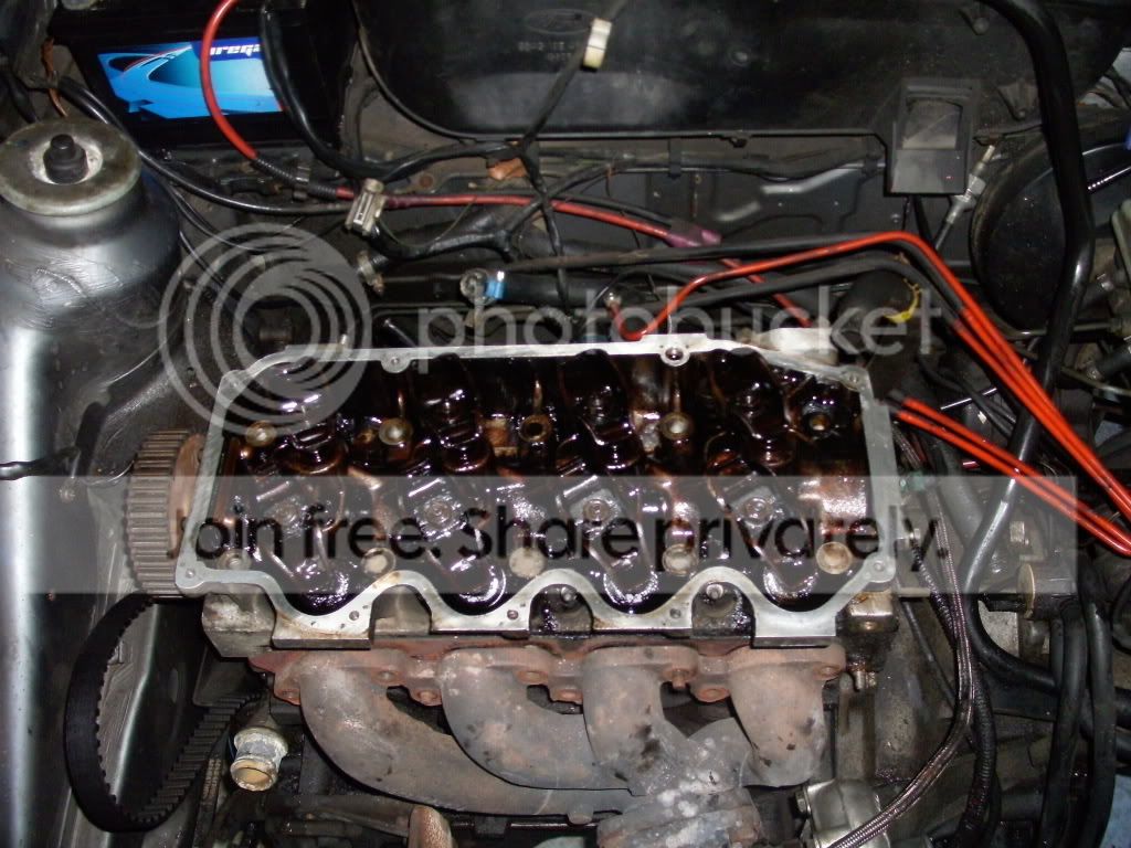

after that i went to EFE but had cooling issues.

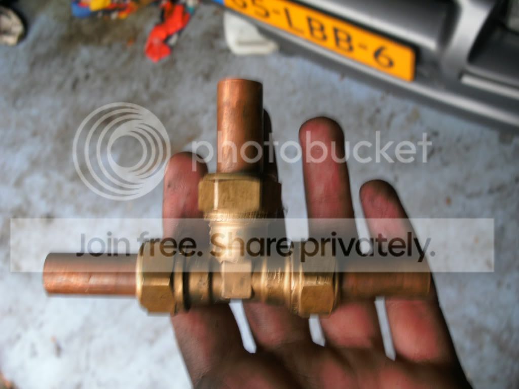

on the way there the plastick t piece for the cooling went bang
i was looking for a new one on EFE but nobody had one so i improvised a little
it worked but still there was way to much pressure in the cooling system so i drove home very carefully.

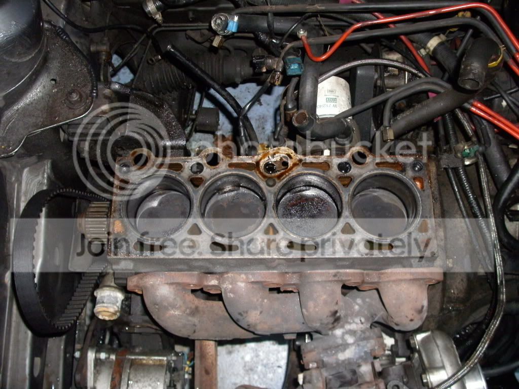

i was thinking the headgasket went to hell so it was time to take the block appart.

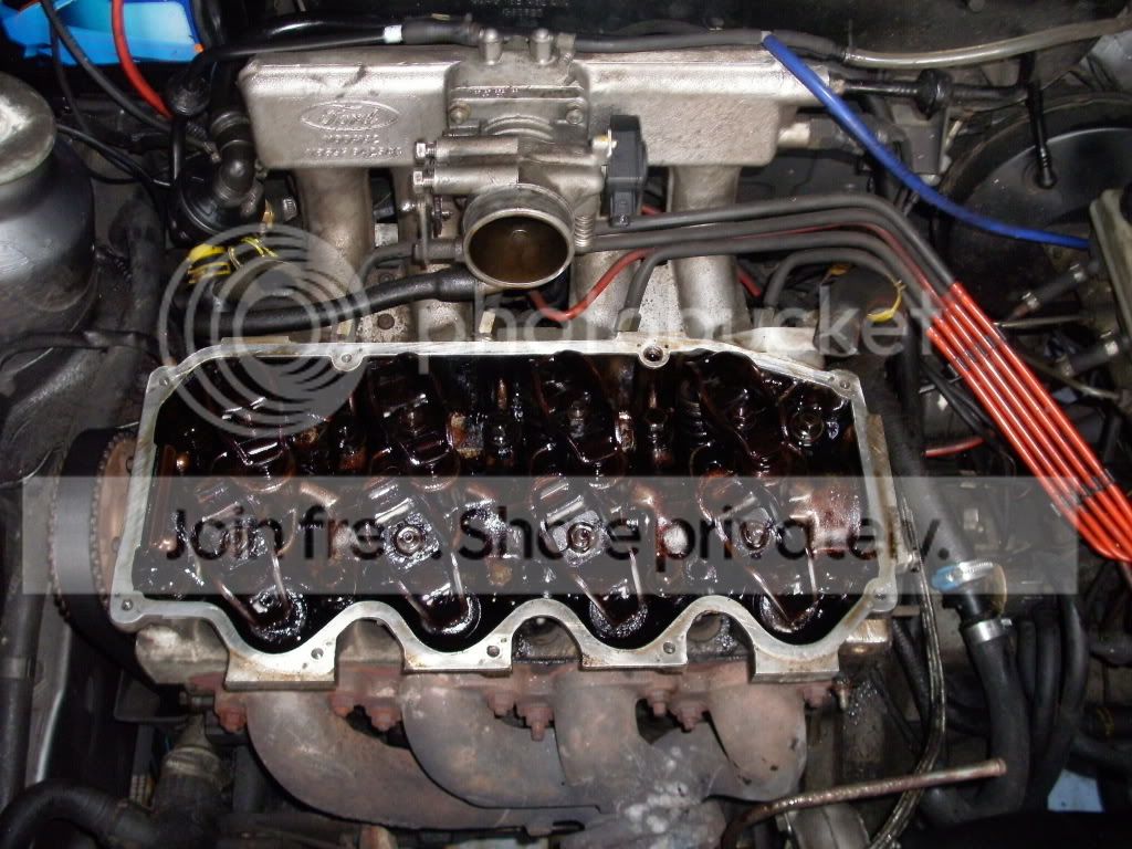

as you can see the rockercover was nicely fitted

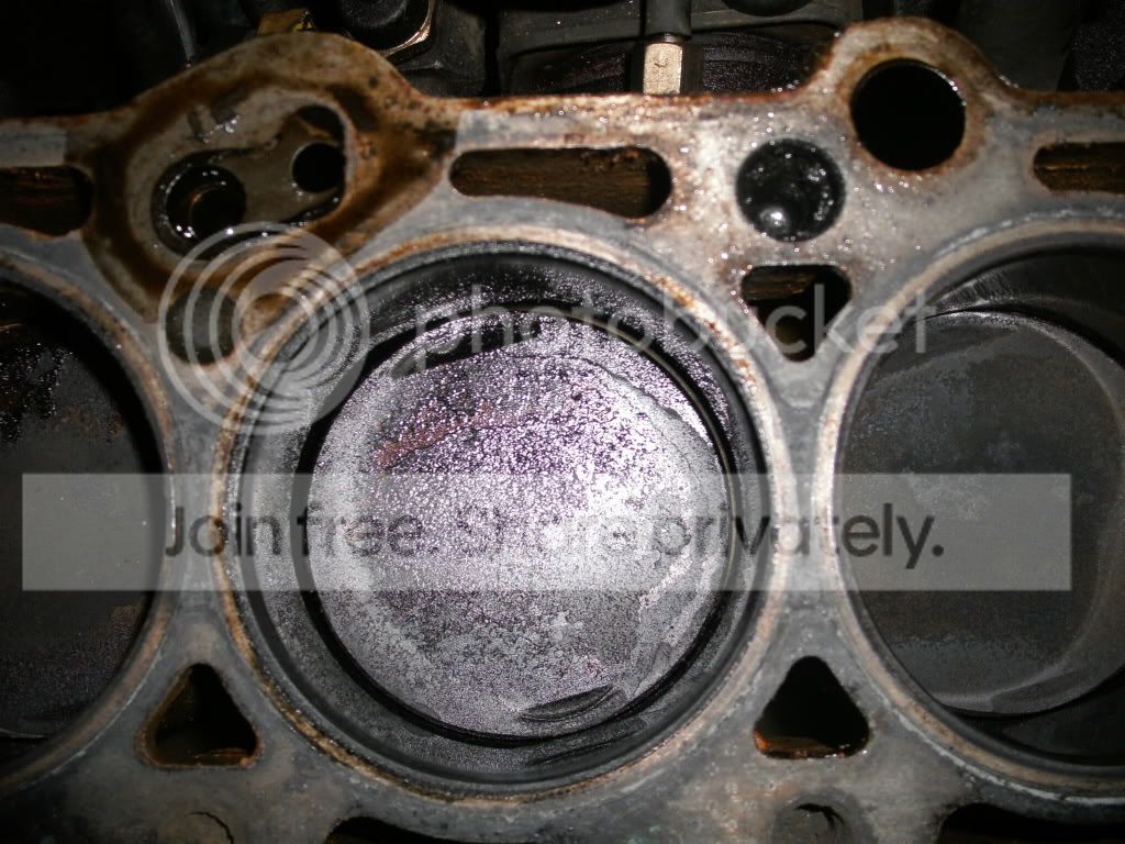

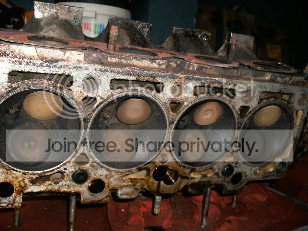

as you can see it was all dirty but there where no cracks or any other dammidge on the block, head or gasket.
then i threw the thermostat in a glass of boiling water and it didn't open so that explained a lott.
but since i had everything apart i was thinking of giving it a full rebuild anyway.
