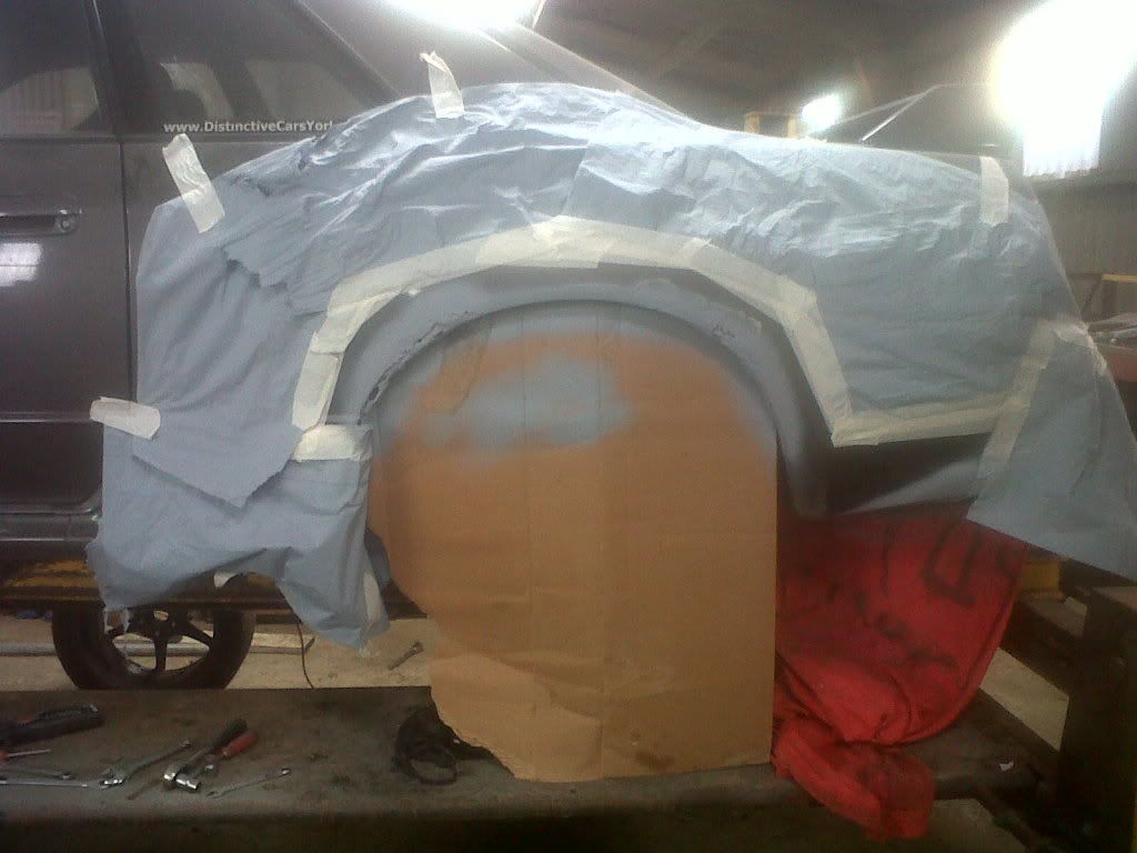

well been busy today fitted the aem wideband, checked the turbo timer and it works runs on for 1, 3, or 5 minutes dependant on setting.

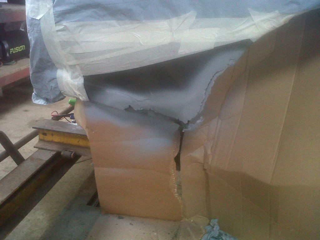

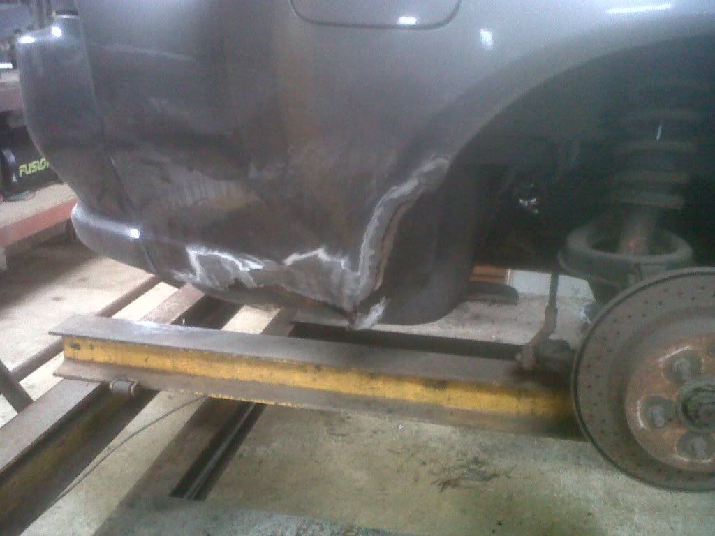

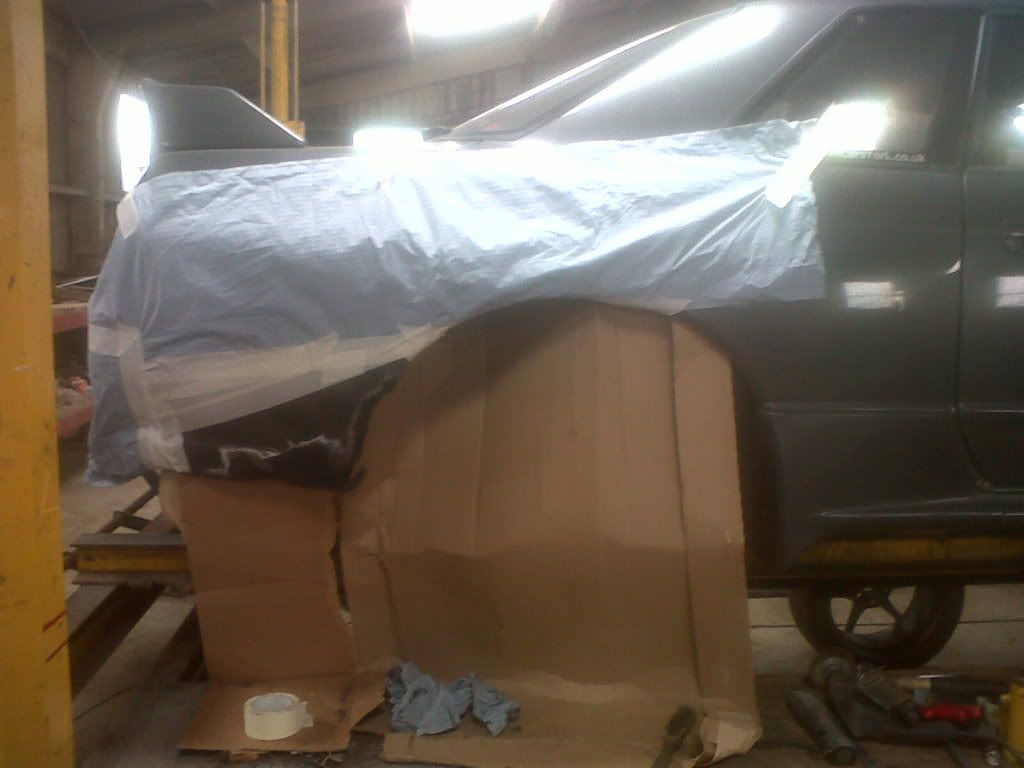

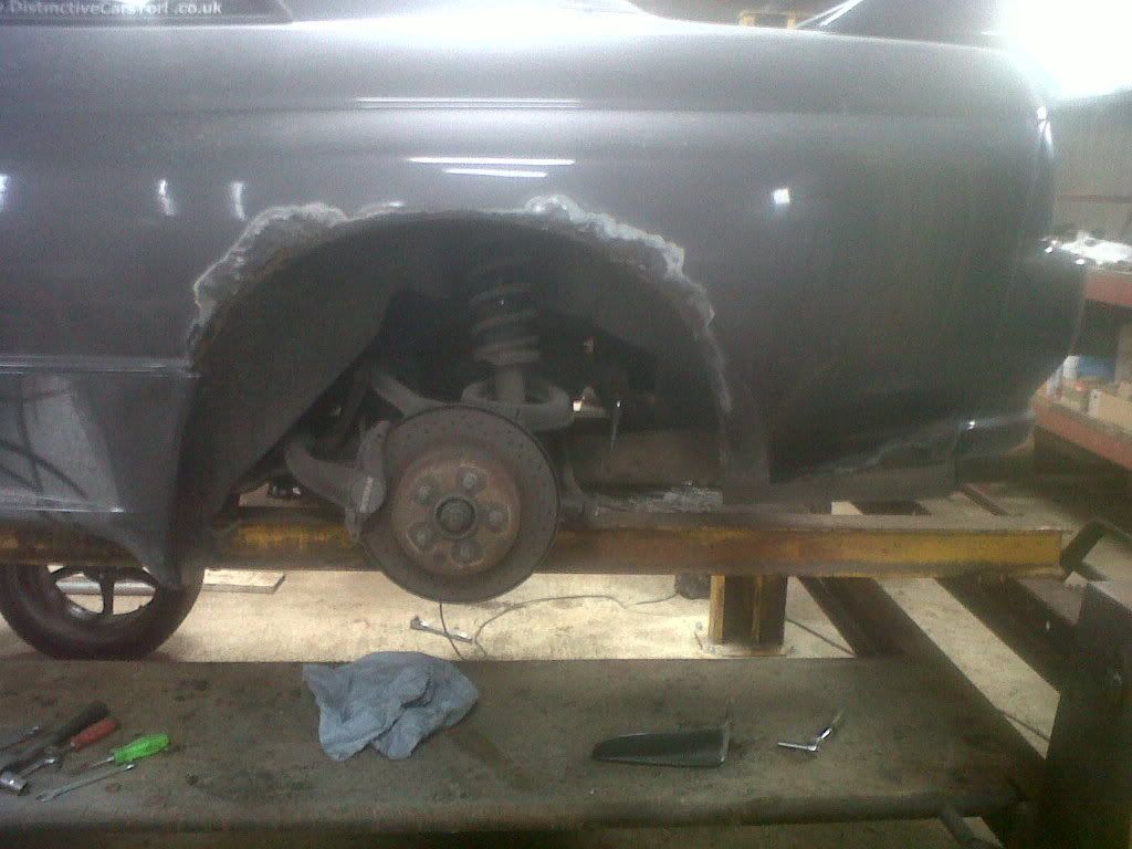

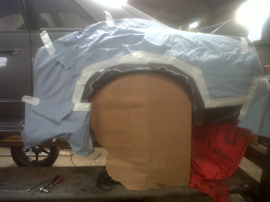

and ive dug out the rust at the back arches, wire wheeled it and kurust treated it, then primed it ready for fillering tommorrow

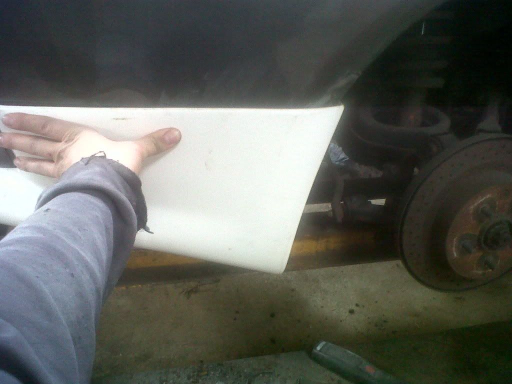

the pictures have come out backwards lol start from the bottom, second pic up i tried a trust copy fibre glass rear spat but there shit imo so im just gonna put to standard with nismo lip.
aside from the rear arches it is a really nice shell for 21 years old, the arches had filler in so has been repaired to a high standard in 2004 i suspect before import.
