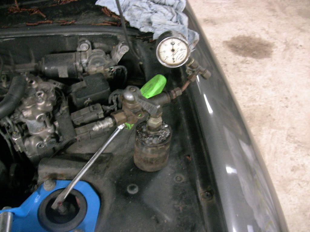

so i made up a fitting for the air filter and pressurized the system to check for any air leaks
has a massive air leak somewhere will not build any pressure at all, i havnt found it yet need to get it on the ramp and check from underneath next.

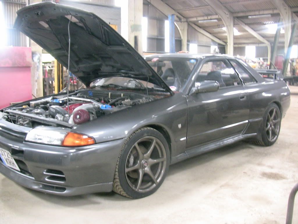

the engine and gearbox have only done 1300 miles since complete rebuild with je forged pistons and new garrett 2860-7 twin turbos capable of 560 hp max.

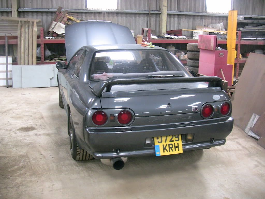

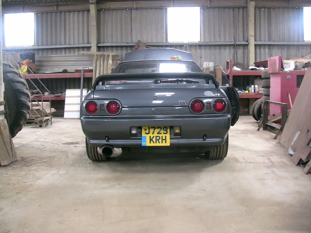

a couple of pics of the car in the workshop

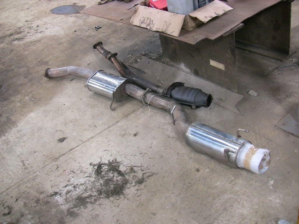

the car has a veilside exhaust in the pictures above but i got a hks silent hipower with it aswell so i fitted that as it has 2 silencers, the veilside had middle box removed and was too loud it sounded shit imo.
exhaust i fitted :
and thats as far as ive got since sunday.
