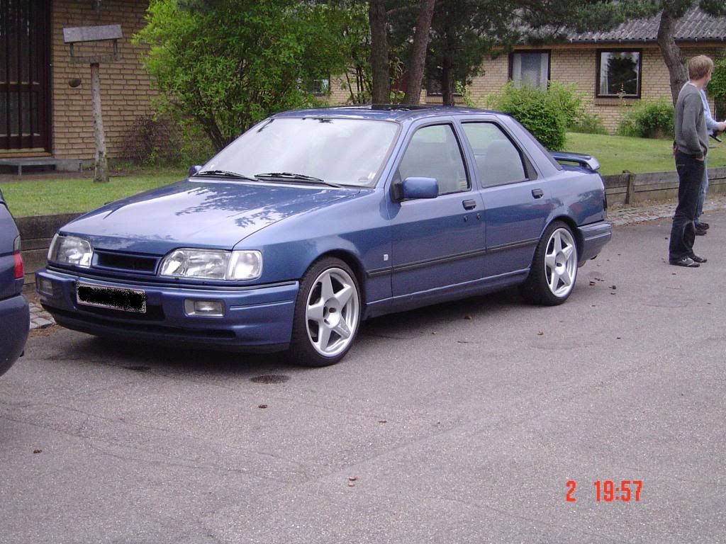

Hi .. my car has sleightly rolled arches with Koni sport/Eibach suspention and I've been running the following setups:
215/40x17 front, 235/40x17 rear on 7½x17" ET35 wheels
215/40x17 front, 245/35x17 rear on 8x17" ET38 wheels (actally I tried with the 245/35 up front and they turned fine but when going they did catch the arch)
215/40x17 front, 235/40x17 rear on 8x17" ET30 wheels
215/35x18 front, 235/35x18 rear on 8x18" ET33 wheels
