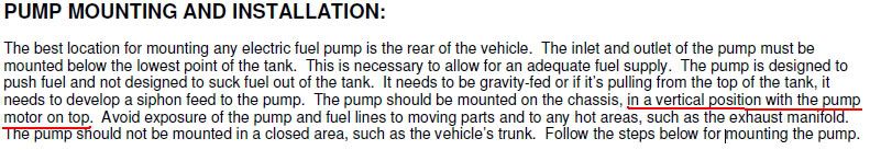

are you sure about the holley pump? as i've seen a few mounted the same as mine
I'm very sure about the holley pump mounting, here is where it is mentioned in the instruction manual that comes with the pump:
http://www.holley.com/data/Products/...199R7914-3.pdf
I don't have any pics of my fuel setup but my fuel tank is in the boot which gravity feeds the holley, which feeds the swirl pot which feeds 2x Grp A pumps. I have wired them so I can turn each pump on/off from the dash if required, they all turn off when I turn off the ignition.
