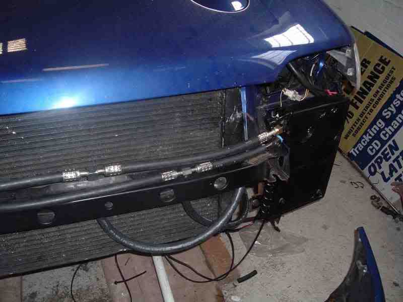

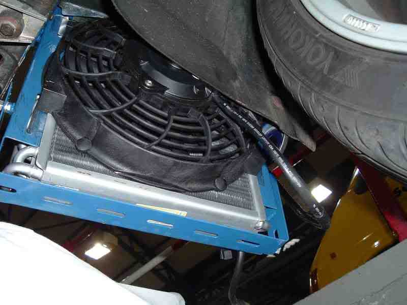

I would advise that due to the fitment of the aircon radiator in front of the intercooler, it only offers a marginal improvement over the standard set up. As you are located in Germany, it should be possible for you to source a pair of Porsche Boxster aircon radiators that fit either side of the radiator like this:
