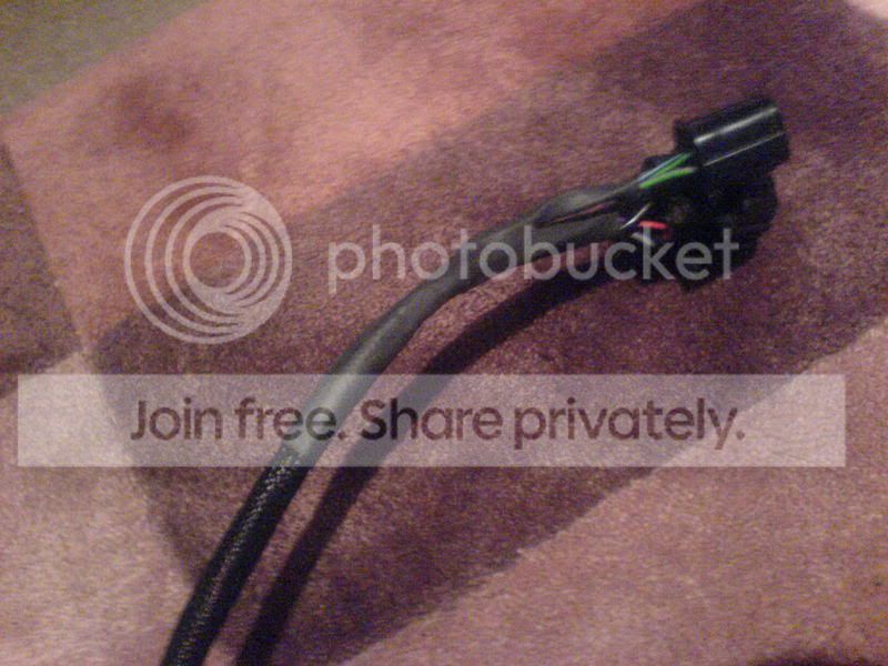

The loom on the NASP engine is pretty much all I need. The engine loom is completely different but this will come from the coupe.
The only difference to the main loom is that the turbo engine runs a 2 stage fan system. The fan wiring is part of the main loom on the coupe. So this has been spliced out and my own custom loom made. This should be the only loom change needed.

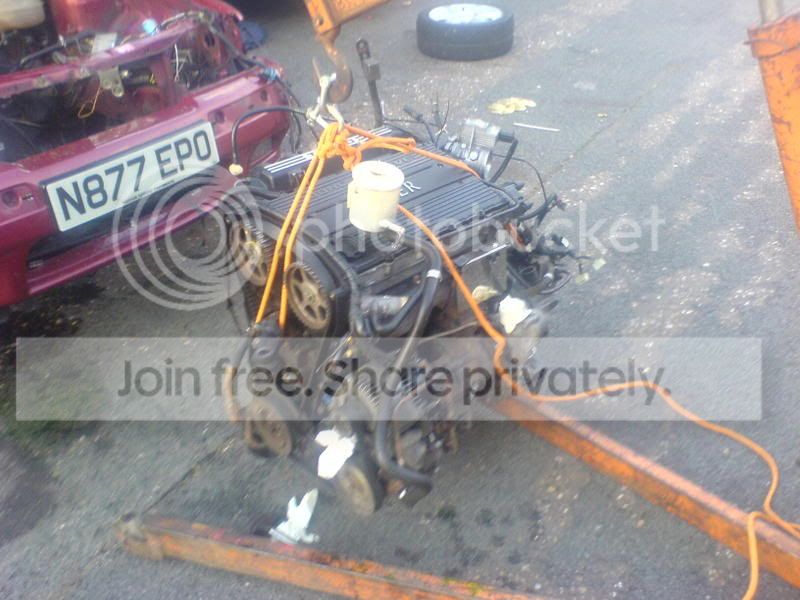

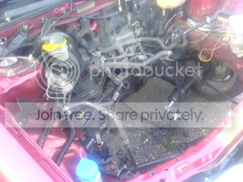

Lump out of TomCat
Engine out of the NASP GSI

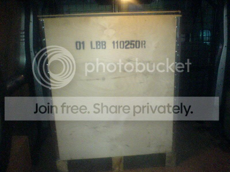

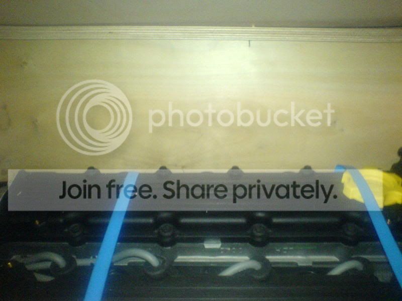

So ebay offers me One of the last 2.0 Litre Turbo engines Brand New for the sum of erm £250.
Take a peak.
