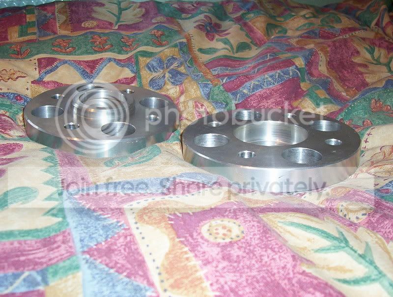

I had these made up for a cossie capri a few years ago (which they fitted fine) BUT I've just tried them on both a 3dr hub and a 2wd sapph hub and they don't fit. The central 63.5mm hub is either 19.5mm deep (sapph) or 21mm deep (3dr). The spacers I've got have got a 19mm deep recess. Measure up your Escort hub centre depth - they may be OK for 4x4 hubs, but I haven't got any to try the spacers out on. If your hub centre is deeper than 19mm, then you won't find any spacers that will fit unless you get a few mm machined from your hubs, in which case these will fit fine.
