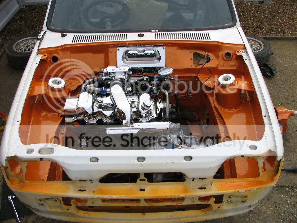

Got the engine in the other day so took a few more pics! Just got the plumbing in to do now!!
Having a mare with the chargecooler at the mo so will be ditching it for an intercooler!

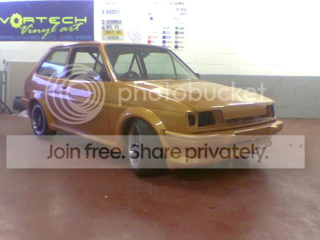

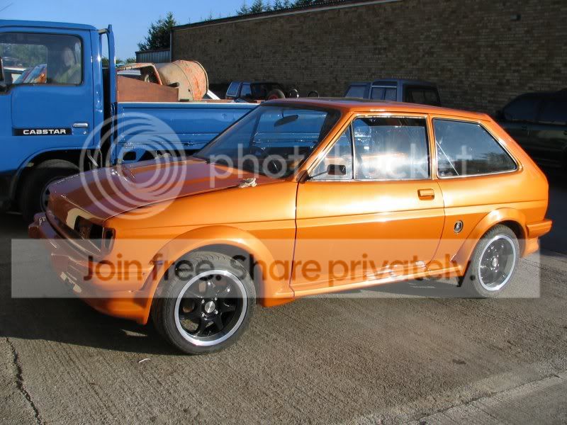

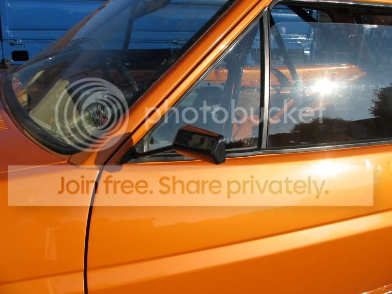

Just a couple of sneak pics with me camera phone with all the painting done! Very happy with the job, and cant believe how much the colour changes depending on the light!!!
Chris

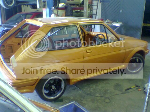

well i got her back from the paintshop last week!! Started to gradually build her up! Coilovers are on, the cossie front brakes/chrome calipers are fitted etc..... Heres a few pics...
my other new toy!
Couple of crappy camera phone pics with the coilovers on!
More pics to follow this week
Chris
