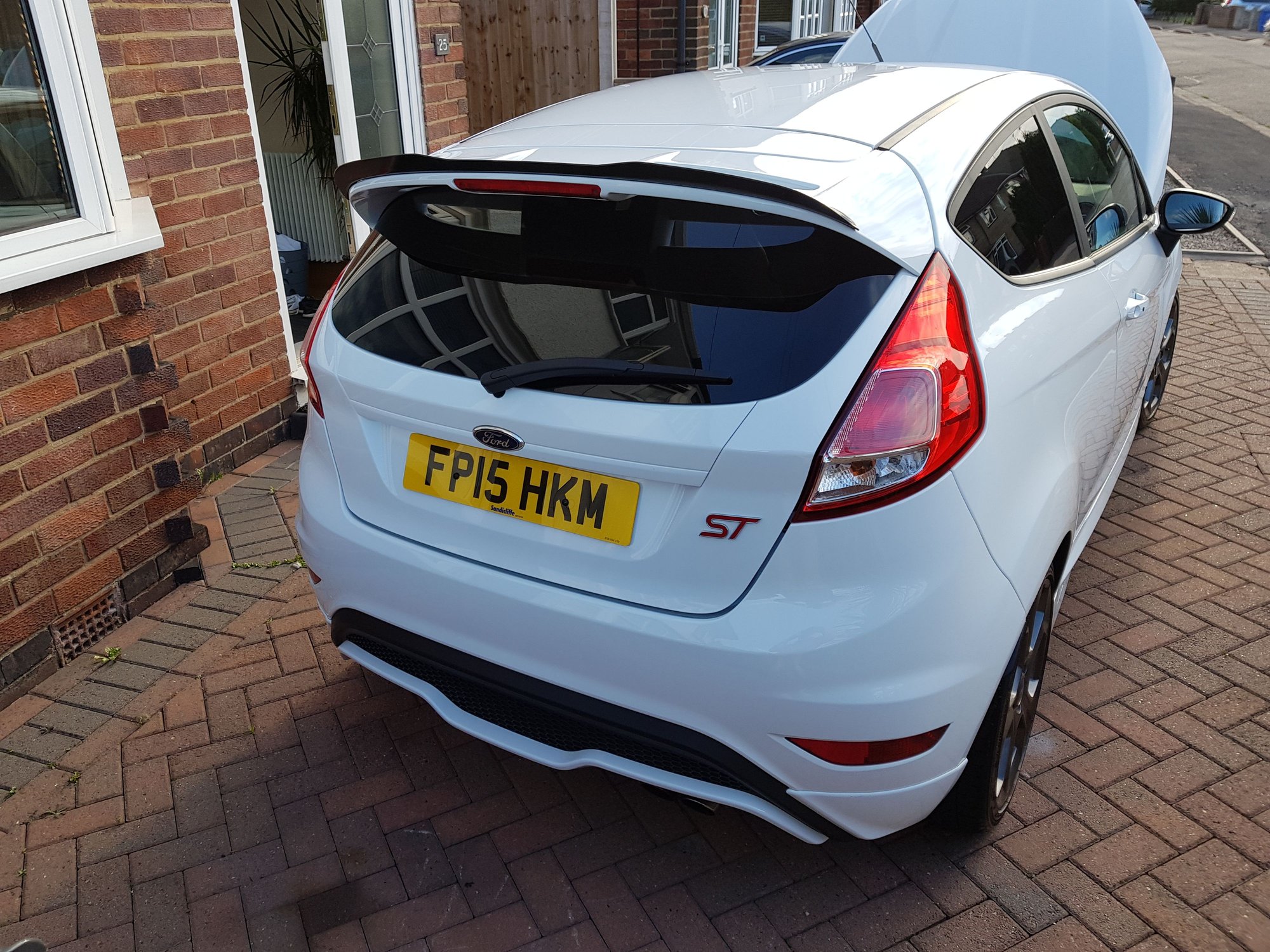

And the new beast lol
new seat covers fitted
Maxon rear spoiler
Front maxon splitter
Maxon rear spoiler
