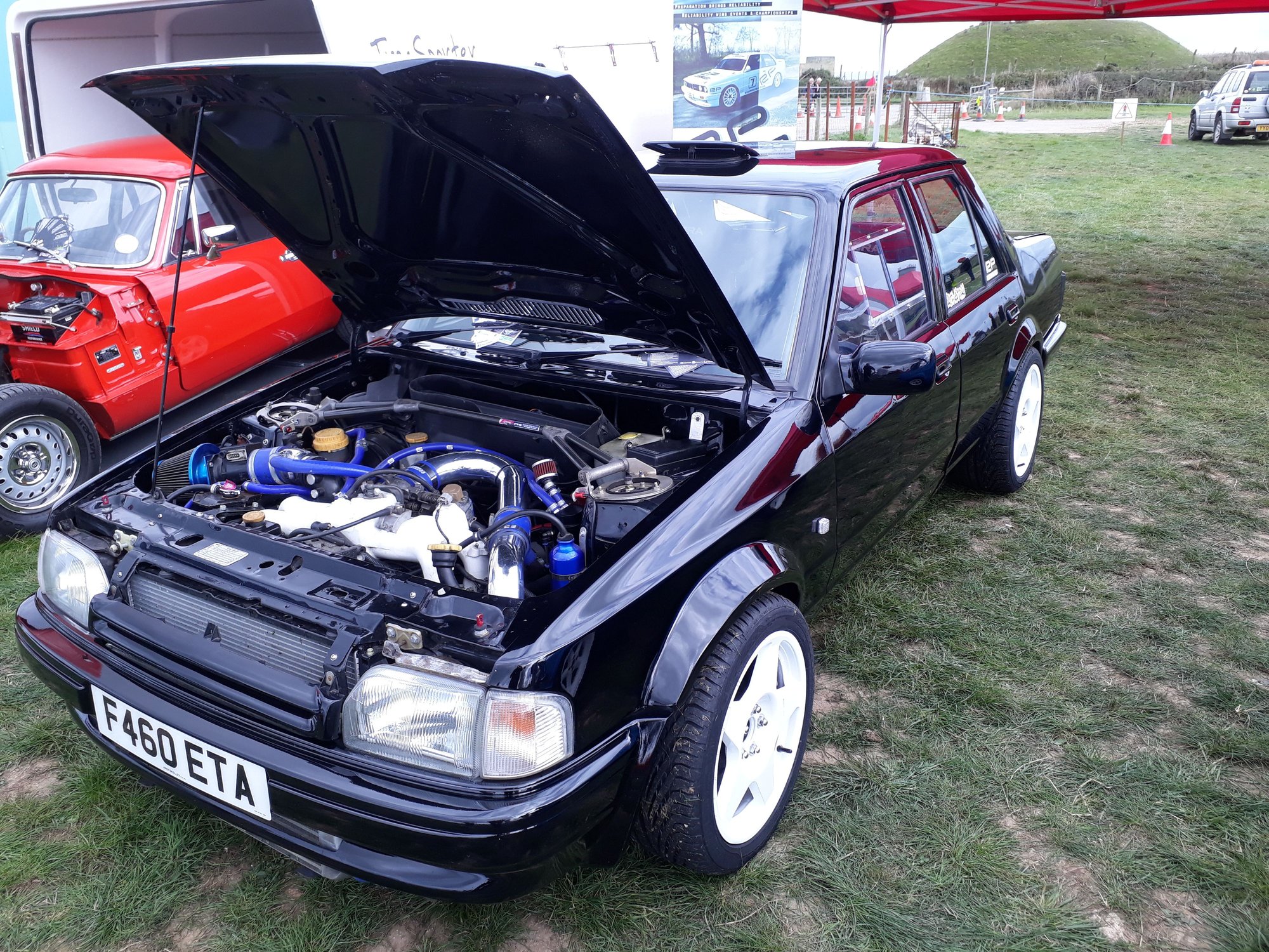

Well, ive got the engine out & bay all stripped down for its new transplant. So suprised how clean it is for a 30 year old ford... my engine choice is not going to impress a few people but tbh its nice to be different, its mainly going to be used for track use/shows ect.

The engine is just over 1 & 1/2" higher & 1/2" wider tham the old 1.6. I test drove the doner car & revved to 9k. And around 230 bhp with K-pro ecu..

So this happened today. Such a good fit, there is alot of clearance which is always a good thing. I also decided to use the original Civic type r mounts & change at a later date. All in all a productive day!!!
