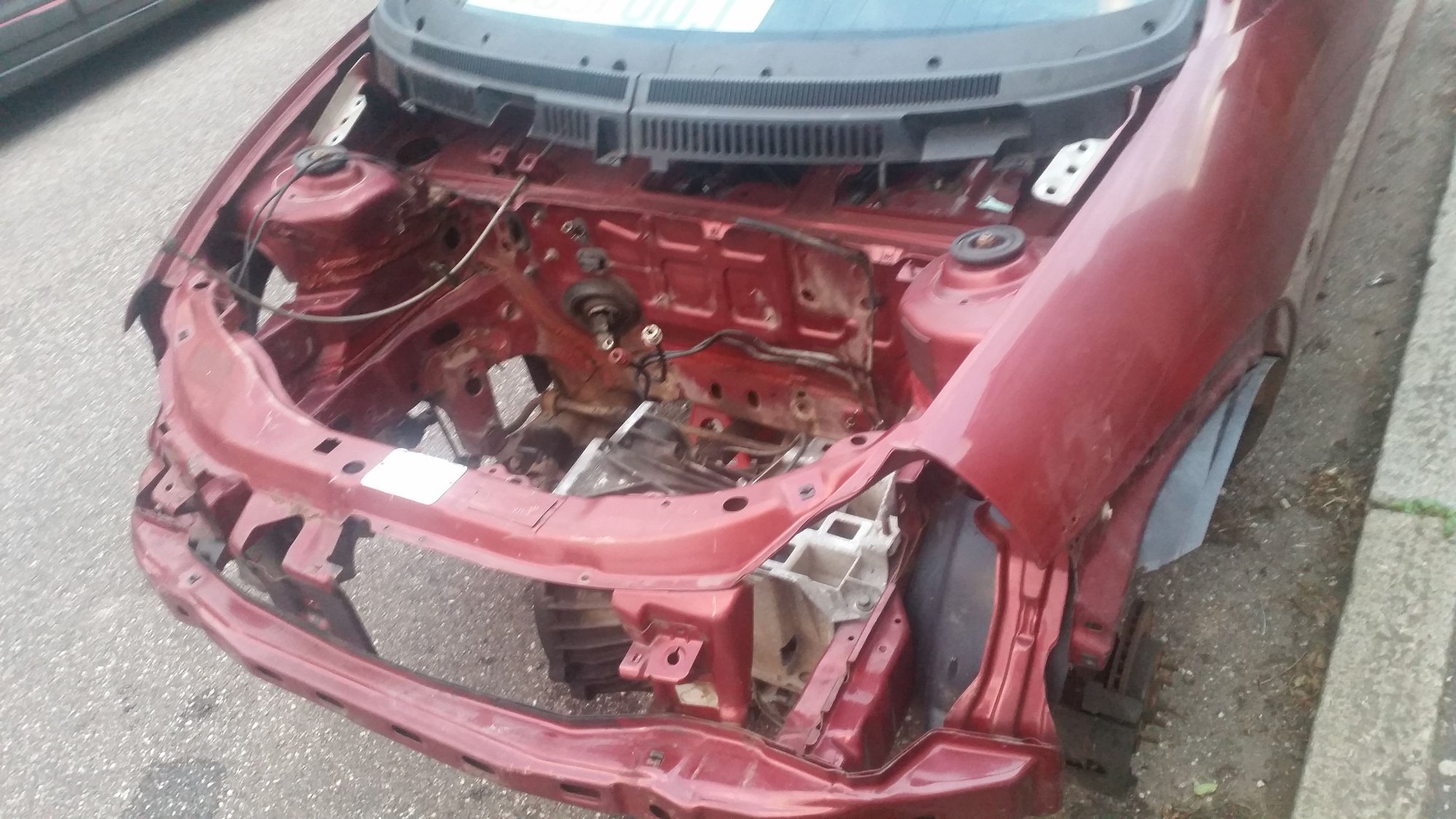

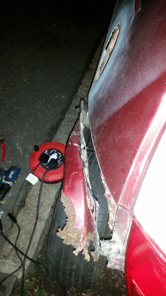

​​​​​​Right so with the car stripped out the next thing to address was corrosion.. The best bit 😣
As people may be aware, the KA is far from exempt from the rusty Ford list.
I repaired the sills to pass an mot when I bought it. But since taking the bumpers off and having a good poke around and clean up I found some more.
you'll notice that this is not strictly in chronological order, but it kinda is. I would sometimes work on more than one thing in a day.
In the last picture you'll see that I also smoothed out the boot

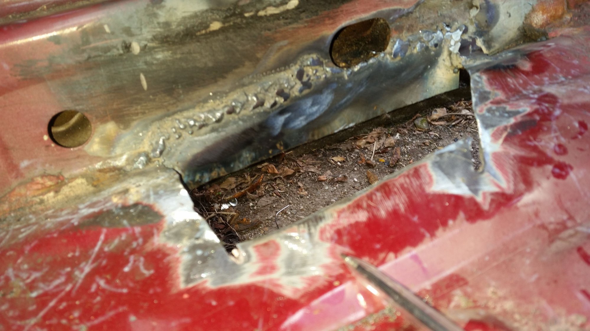

I would like to say that going into this I had little welding experience. I bought a cheap welder from lidl, expecting it to be a gas mig welder, turned out to be a flux cord only welder. Oh well. Im far from Mr money bags so I had to make do with what I could afford. I hadn't known how to set up a welder prior to this, so I decided to start on the floor pan as it seemed the most straight forward...
​​I had used a gas mig a few times before, but using this flux cord was a different experience, especially as I was still (and am) a very novice welder. Anyhoo this was my first go at flux cord
I must admit the spatter threw me on the settings as gas mig doesn't spatter anywhere near that much and you don't get the slag etc.. so I was adjusting here there and everywhere. But it's in and it does the job.
The next things to weld were the holes left from the heater matrix etc
welding starting to improve 🖒

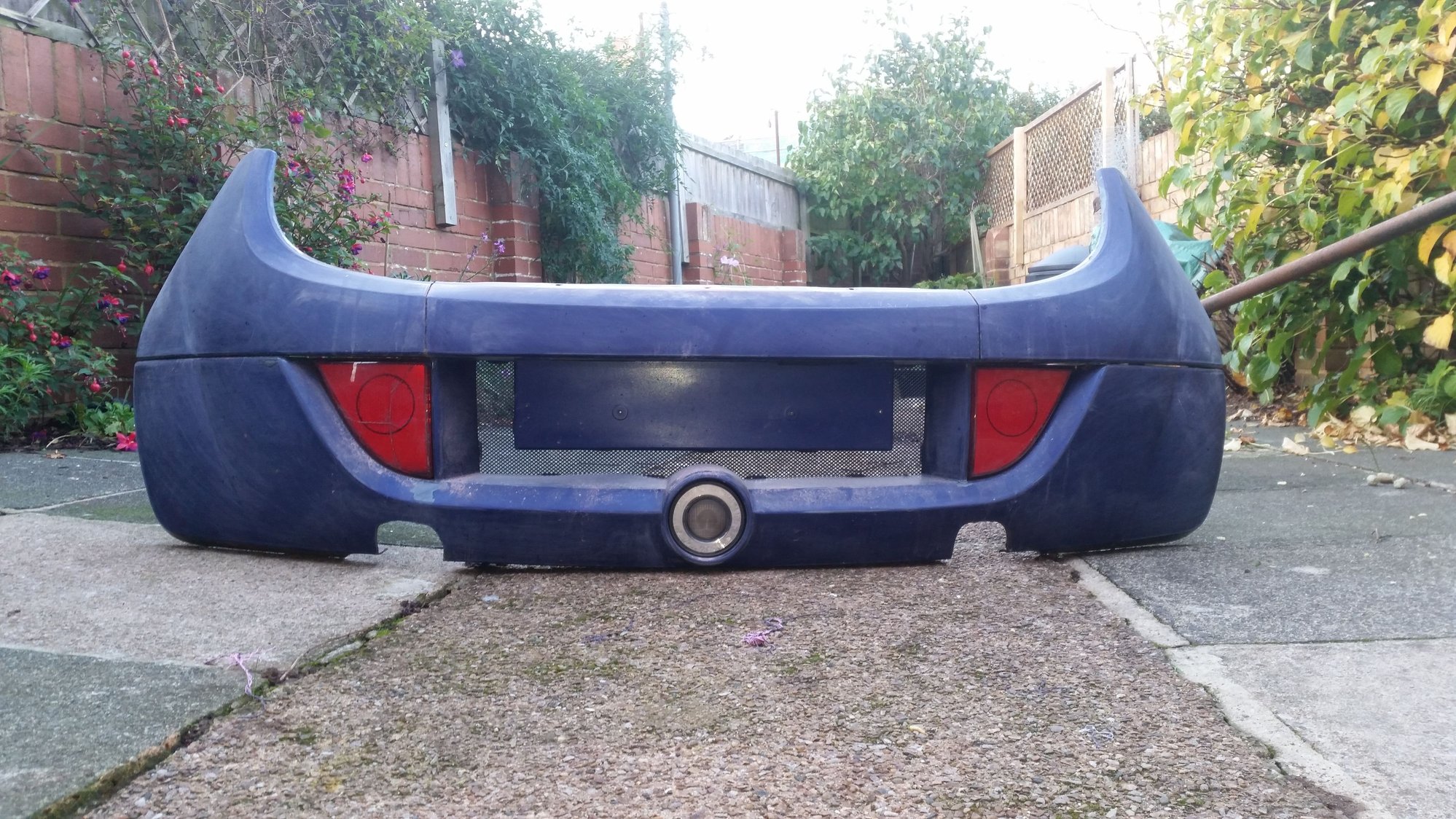

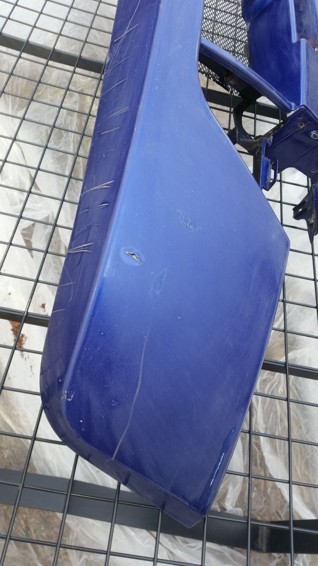

Someone mentioned about the sport bumpers allowing for wider wheels. This is true. I bought some staggered 13" banded steels, and I intend to use some 25mm spacers with them on the rear, as in the future I will be getting a decent set of wheels.
Plan atm is to get it on the road as I still pay tax and insurance on it.
I got them back into shape, gave them a couple coats of high build primer and some engine enamel as they're only a temporary measure. They still look good.
They came with stretched tyres and would just fit the arch with the full width tyres ill be using, however they wont fit the lightweight wheels ill be getting in the future which will be 25mm wider. (Hence buying the spacers). So i decided to extend the rear by 50mm in total.
I cut where the bumper clips to the body, in order to retain the fixing points.
I'll come back to these a bit later once the spacers arrive.

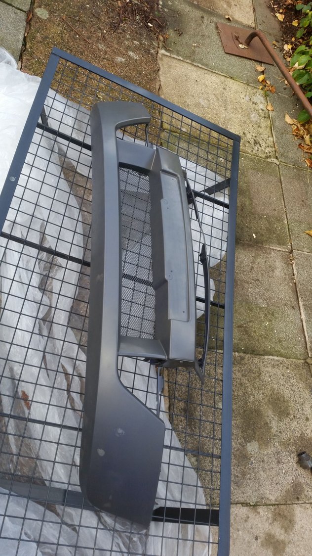

It's not really the right time of year to be doing painting and bodwork outside, but it has to be done.
I bought a new bonnet, and fixed up the sport bumpers.
Plastic primer/adhesion promoter
High build primer

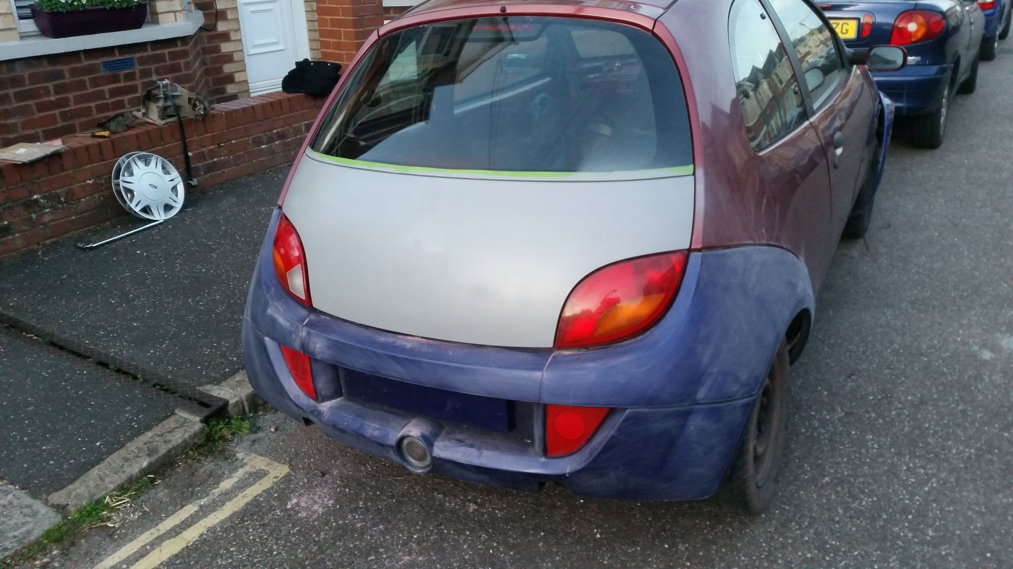

Cut out the sportka reversing light and straightend it up a bit. Fiberglass and then will cover with some body filler.
I really like the colour of the dark grey plastic primer, so i might get it colour matched and do the whole car that colour
Brand new bonnet.

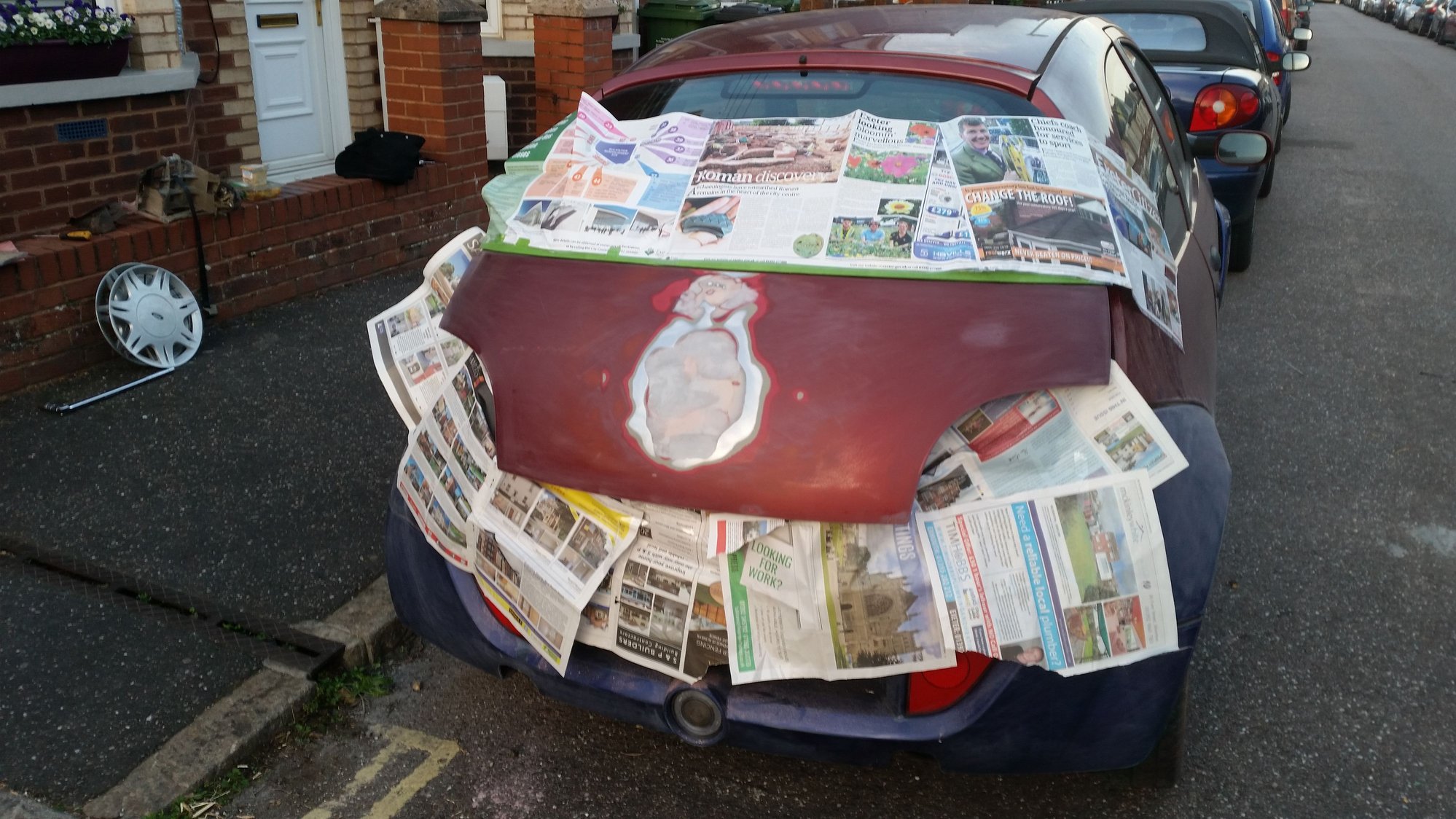

Quick jump to the to the present day (or yesterday) and a sneak peek of the rear getting widened by 40mm

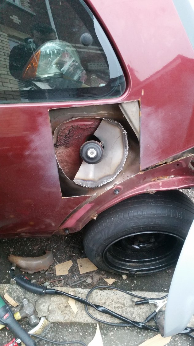

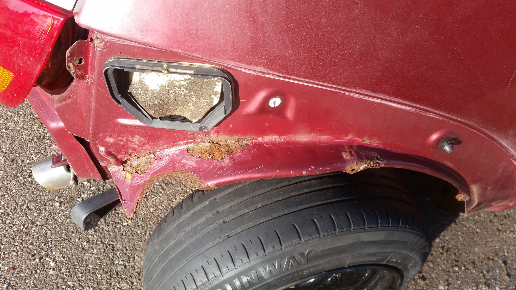

The KA is notorious for the fuel filler cap are rusting, this happens as the rear arches have no plastic liners, the wet mud sticks in the arches and holds moisture. It eventually creeps through to the outer surface, by which time it's a mess underneath
There is an internal "extension" panel available, but the rot had got further that that so I just chopped the whole lot out and did without the mud catching cup shape.
