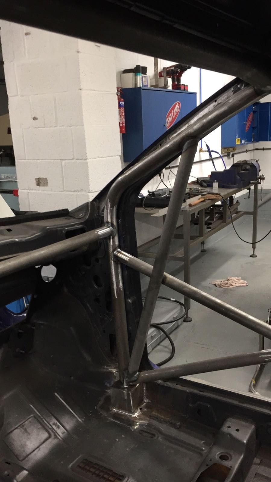

I suppose a cage was I good start so I opted for a tig welded item. Plenty of bars to keep me safe
Double door bars with vertical yet to go in
WRC spec top mounts and turret mods. Marks work is amazing
Once again amazing skills
Don't worry about the v bar it's only placed in and will be central when welded
Hand fabricated gusset on the windscreen pillars

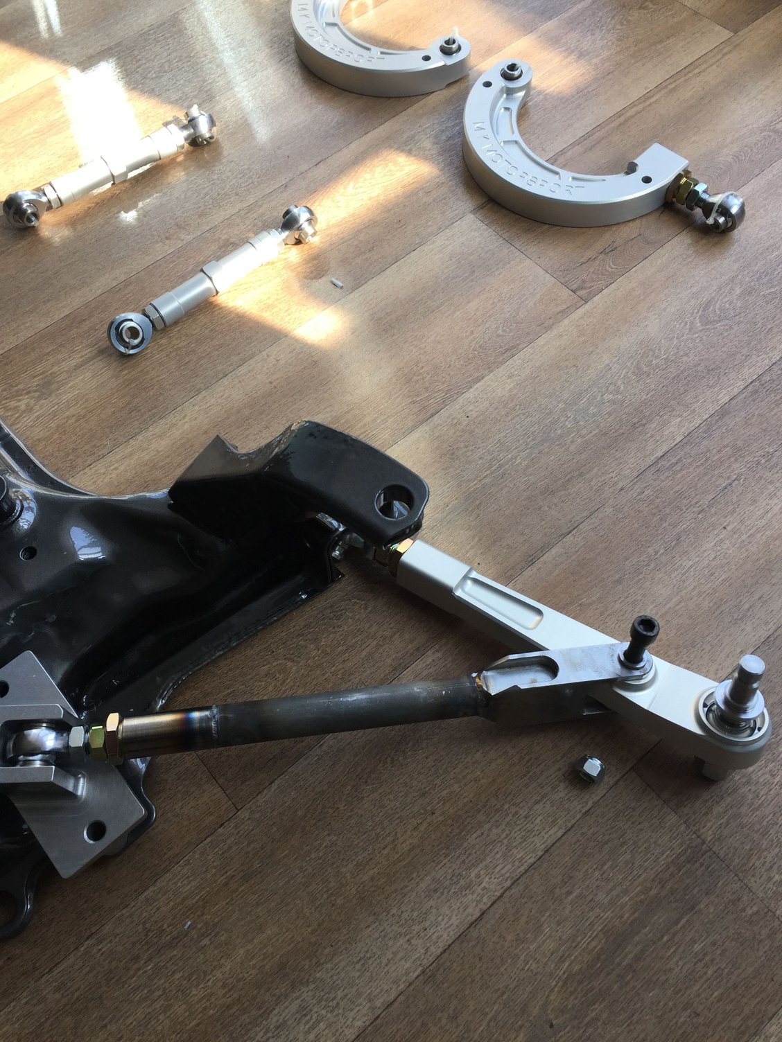

I commissioned some bespoke parts from Mark as I knew his workmanship is beyond reproach. I wanted ultimate adjustability in the front and rear. Here's what he came up with.
WRC spec tca's and rear camber arms
Simply brilliant
Billet mounting block for compression struts a
All rested in place on the front subframe. I'm building all the sub assemblies so it'll be a quick job to get the shell rolling
They are adapted from the cosworth stuff so should be up to the job

Just a few of the cage going in. Mark is working hard to get it done.
