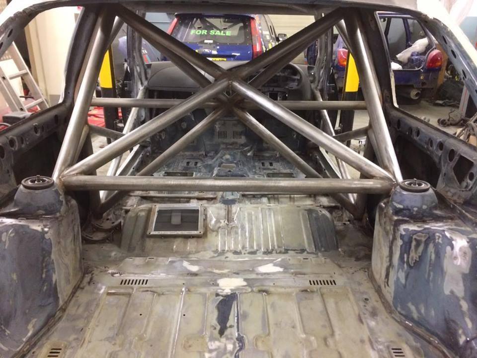

Turns out not long after he started looking this came up for sale 10 miles away at a stupidly cheap price.
Spec
full cage
fully seam welded
seat rails lowered and welded in
sill stand points
2 new quarters
brand new sills
most of the fabrication work was done and it also came with alot of parts.

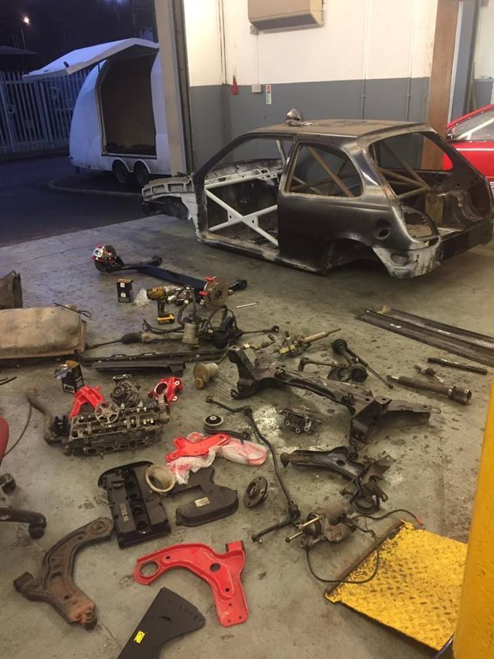

At this point i agreed to help him as long as spent some money on it, he grudgingly agreed.
The seats and half cage were sold and it was basically paid for.
So around December time we got to work on it a couple of nights a week and the odd weekend.
The following isn't exactly in order.
He got ordering some parts, been looking for good quality second hand.
seats,harnesses,oz wheels, new radiator with built in tank as rollcage is in the way.
Knocked up some sill stands
Did lots of little bits of welding. Finishing off quarters, sorting some rust, getting seats to fit, plating holes. Test fitting doors. made front end and wings bolt on.
Stripped the underside
Made a start on rear quarters/arches, flared alot before a light skim of filler.
Spec
full cage
fully seam welded
sill stand points
2 new quarters
brand new sills

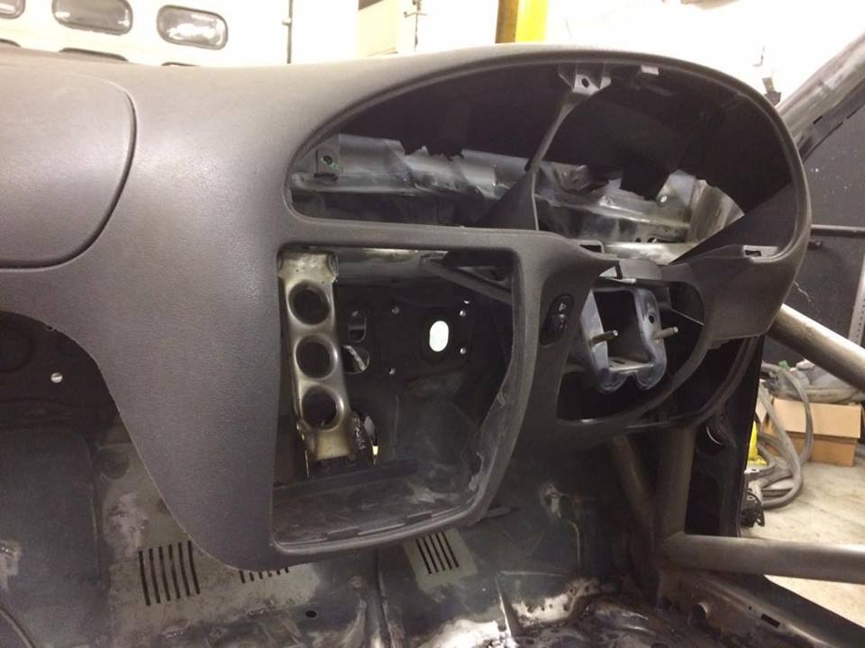

And to bring us up to date.
Trimmed and test fitted dash. (this will be getting flocked)
Had to make a bracket to support the middle.
Lots of sanding.

First time i've painted a cage like that, never again. Turned out better than i was expecting though.

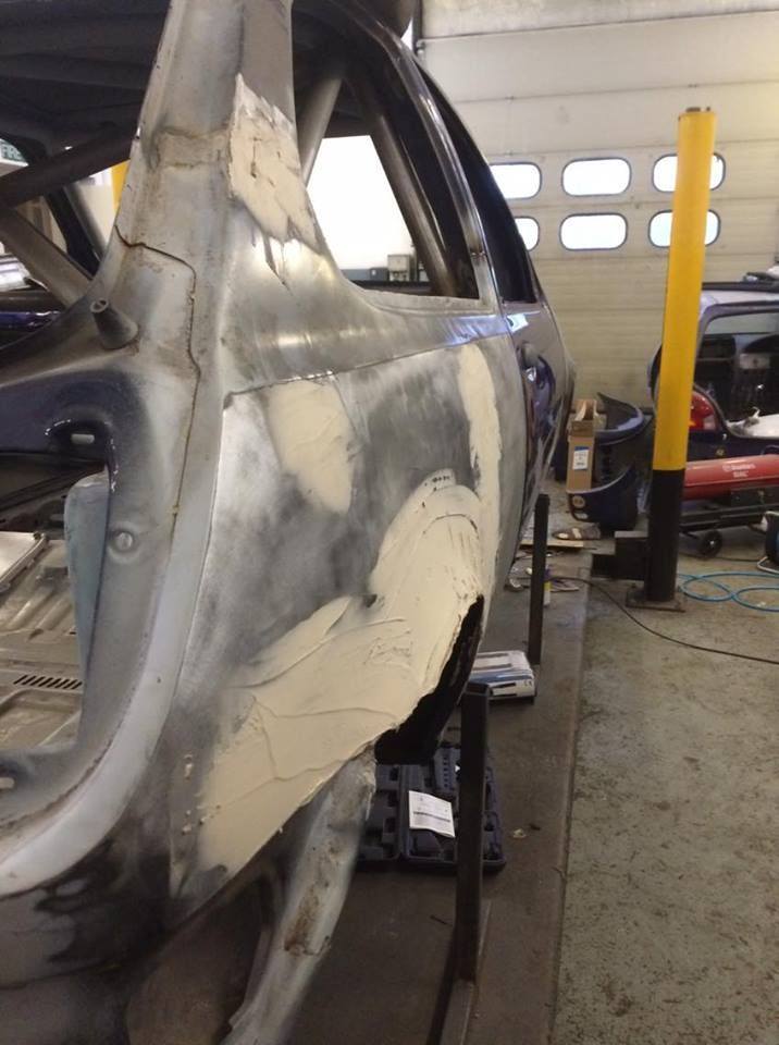

Got a big chunk of bodywork Done on Saturday afternoon.
The reason for the lacquer peel on the roof became clear, a previous questionable repair.
Although both quarters were new the driver side has had a few knocks sitting in the previous owners workshop so was a bit of a mess.
Its going to have a few ripples but at the end of the day its a track car and white paint always helps

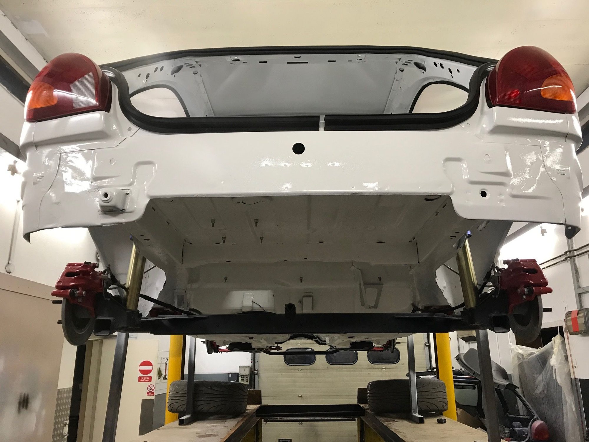

Been a while since i've updated this. Made a little progress.
Car painted White
Rear poly windows, lights, steering column, pedals, seals
Brake system and Braided lines.

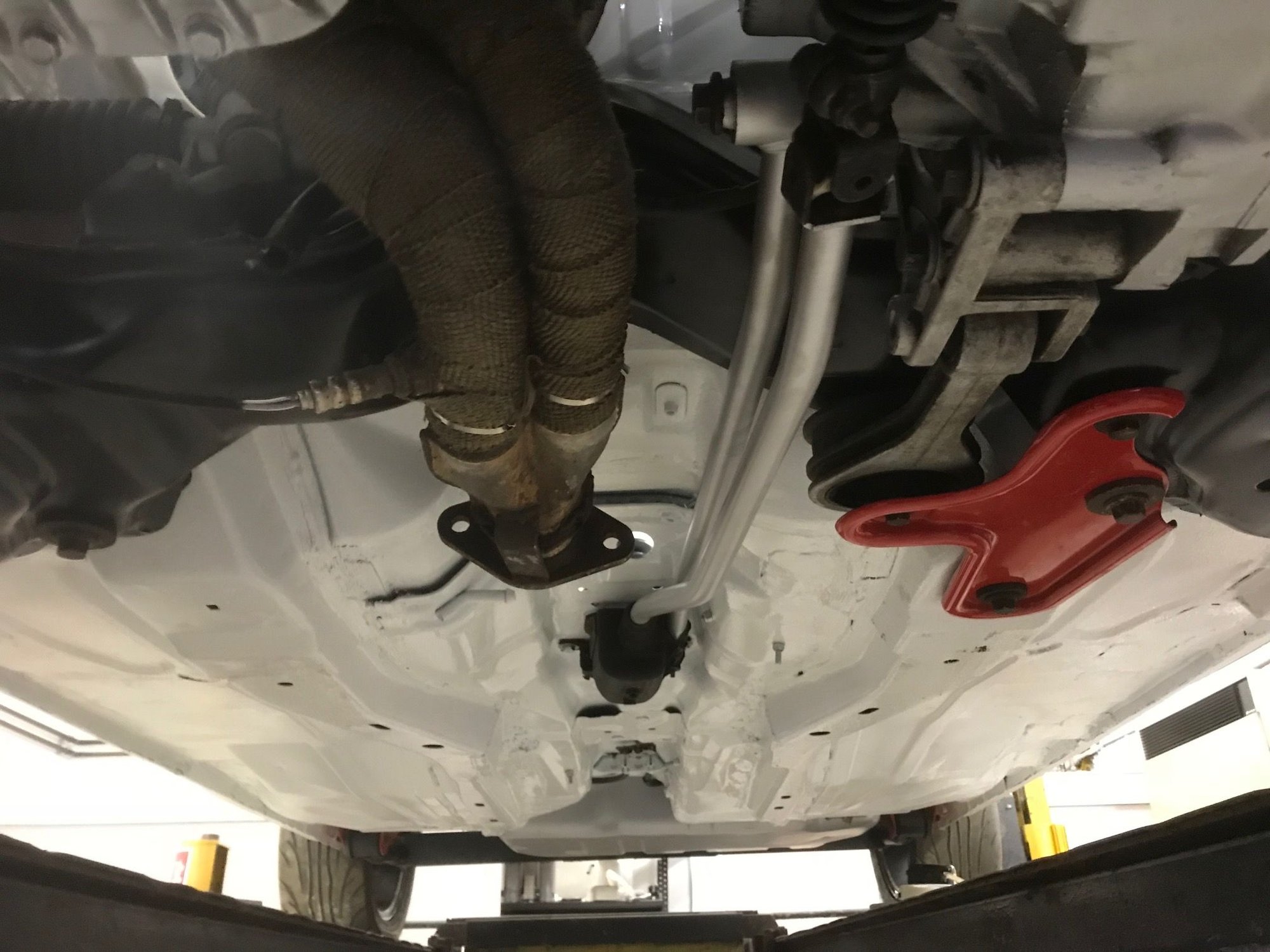

Then we started on the engine and also the looms.
Heat Wrapped mainfold, painted Rocker cover and engine
All new gaskets, belts, water pump
fuel tank/lines, gear linkage
