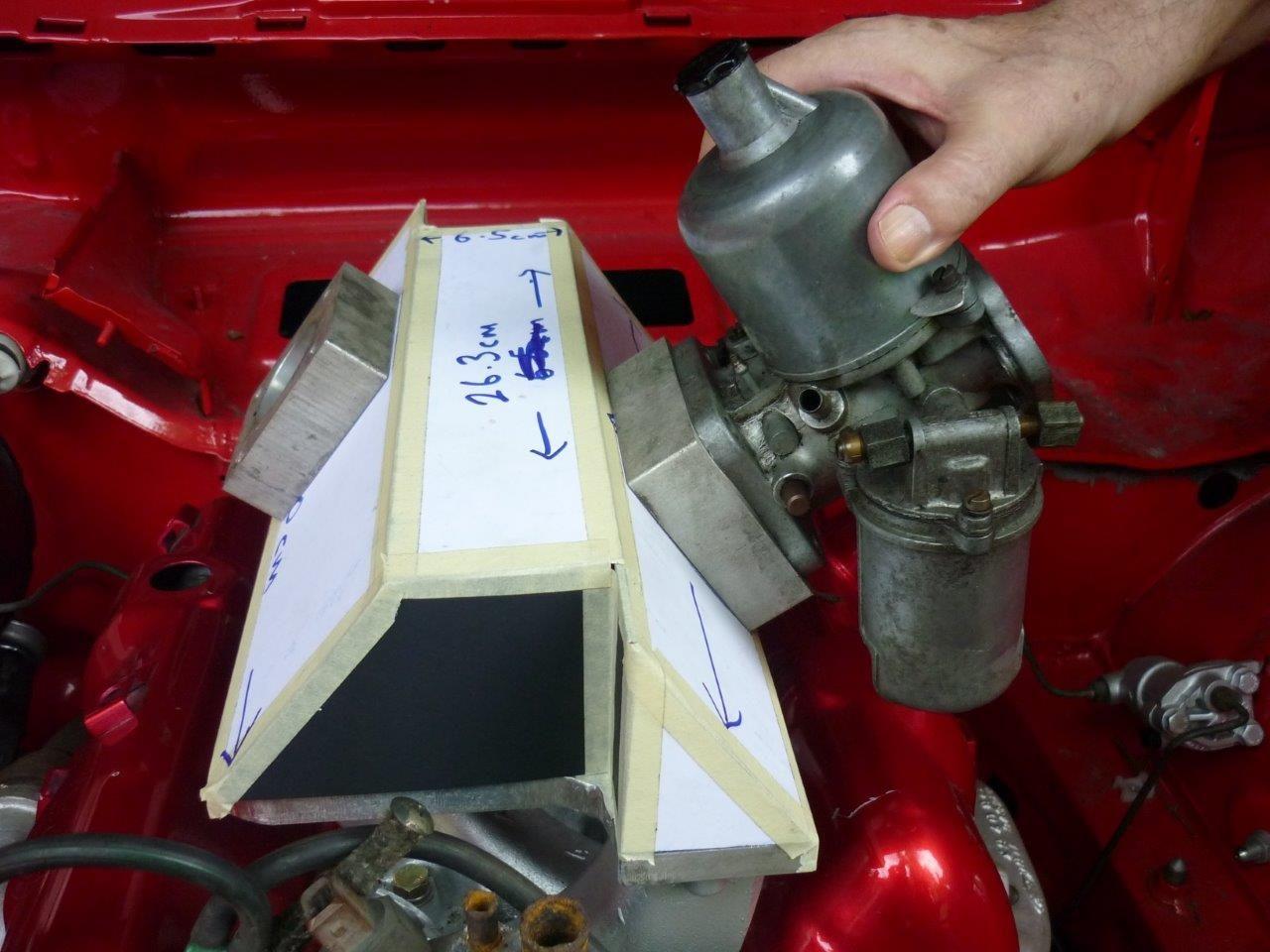

The Bosch Fuel Injection was a bit of a nightmare and added complexity without much benefit. With a lot of discussion we've made the decision that at least for now it has to go. So we've started fabrication of an inlet manifold for carbs, twin SU's seems to be the best and simplest answer, this should only be for a season. Bonnet will be coming off so we can get a GRP mould made then we will cut an airscoop and cooling.

It's a good point. Smarter people than I are saying it'll work. Good spot we are using SU's from a Rover V8, early Range Rover ones as they are easy to get access to and service. They should do what's needed.

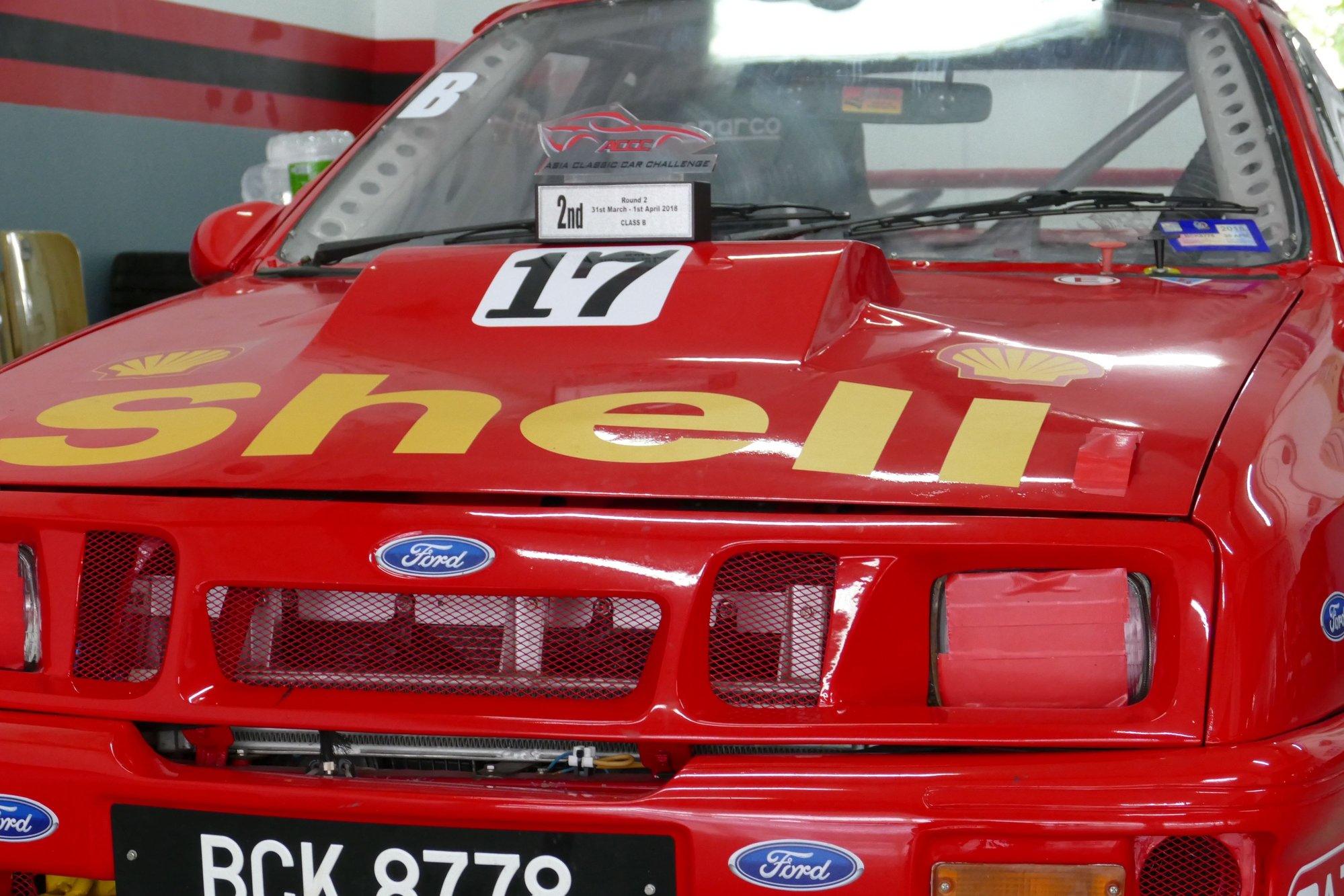

Well it's ready for race 1 at Sepang over Easter weekend.
Probably worth mentioning what I've done.
Full Group A cage seamed into the chassis with strengthening to the turrents and extended front and rear including down to the diff.
All solid bushings and rose joints with adjustable rose joints including compression struts on the front.
MK Motorsport 6 degree rear beam.
Accusump with oil cooler using all aeroquip fittings and braided lines.
Gripper plated LSD full race spec in a new case built by Barra.
Gaz Gold Race coilovers.
Custom prop with strengthened UJs.
Front brakes are 330mm discs with AP Pro 5000 R 4 pot calipers.
Rear brakes are Wilwood calipers with 300mm discs.
Entirely braided brakes hoses to front and rear.
Custom dash with switch gear and dials.
OBP pedal box and bias control.
60l fuel cell sunk into the boot with boot mounted pumps and filters on braided lines using aeroquip fittings.
Under bonnet fuel cooler.
Makrolon windows with NACA vents.
Team Dynamics Pro Race 1.2 wheels and a random set of Oz (Sparco) for wets.
and probably more I've forgotten.....
